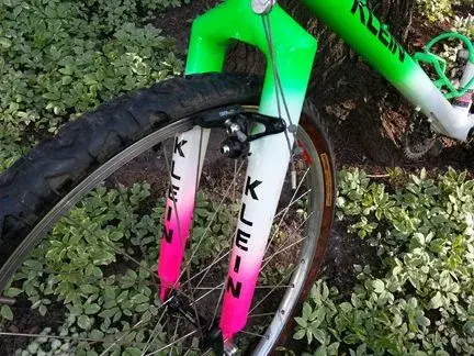

Hi Martin,
Picked up an early Attitude, Dolomite with box fork solid black decals Klein embossed headset seal, frame is A205 (followed by a circled K) and fork is PT13D.

That's a 1991 frame, I have seen some forks with the PT number as well. Some early 91s still got the embossed headseat seal. I have one like that.
I wonder if the 1991 Box forks may have the PT serial number... that would make sense.
