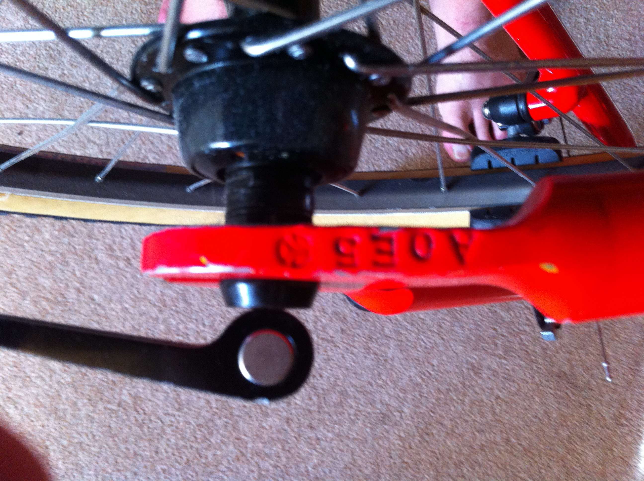

I think your hex theory is pretty convincing.
No pics as everything in storage at present, but my attitude would be #1365 of 1990 going on the serial number.
It's a 'K' then a BAT, which would give weight to your suggestion that new 'post-issue' 1990 frames went out in 'B' configuration, whereas ones already made / modified had the 'B' stamped retrospectively - ie. B'K'AT...
It has c/l cable entries, but I'm fairly sure it has a red seal BB, so probably another mongrel of some sort.
No idea of fork serial, but will check whenever next near the bike...

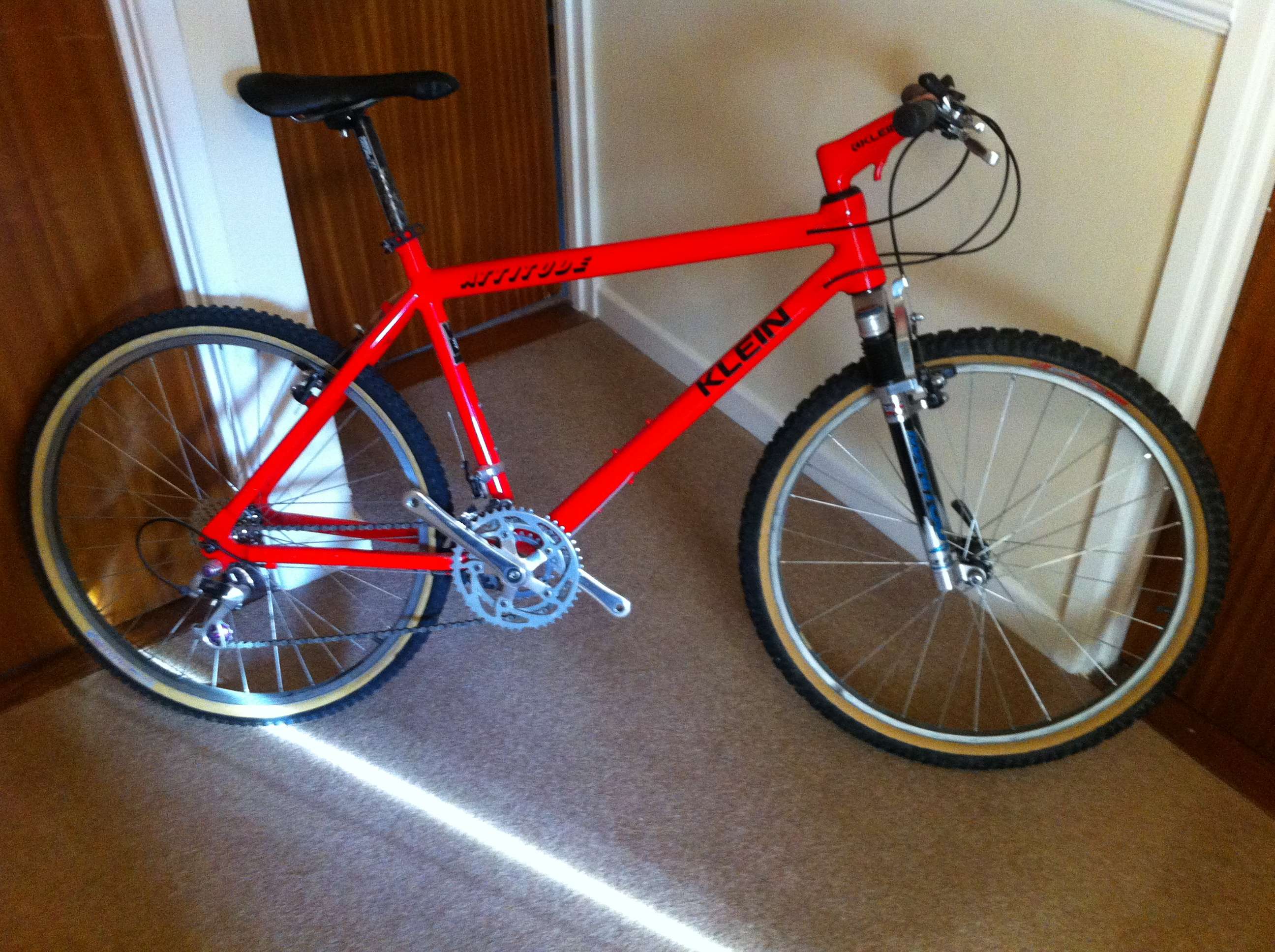

That's 'Flare' red, not 'Flame', and if you want to swap your MC1 bar / stem combo give me a shout!
BB.
