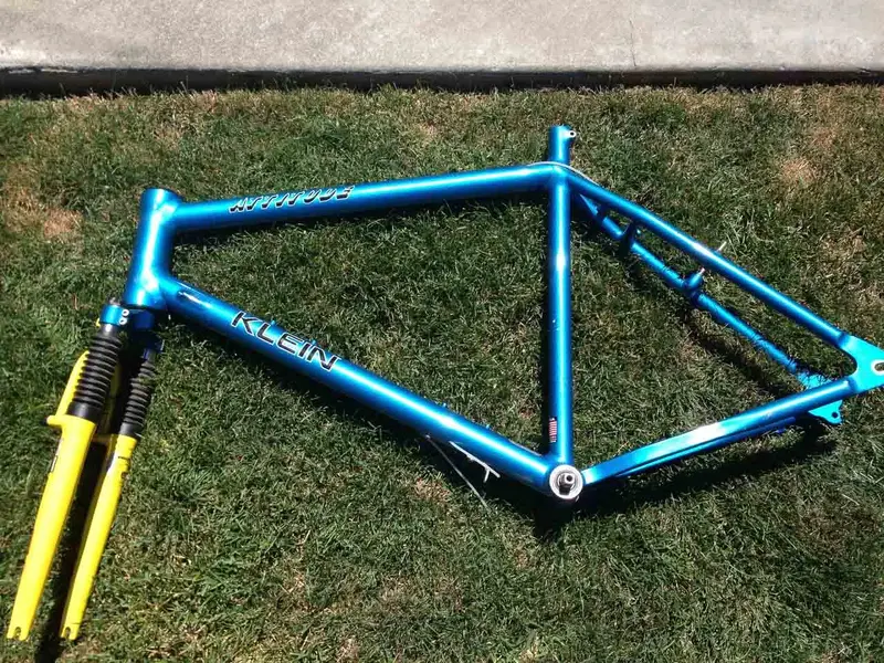

20" 1990 Team Attitude BAT4F8 FORKS: 5A5A8
22" 1992 Klein Attitude (Blue), came with rock shox A173
Got any pics???
The XL 1992 seems more like a 1991, #371

Here's my two cents:
One 1990 Attitude, KLEIN embossed HS seal, original paint, frame serial number is BAT501 and the serial number of the fork is 5A5D2:
One 1992 (or maybe 1991?) Attitude that's out for a repaint in HLF, serial number of the frame is AA3 and there's a MAG-21 fork in it:

mine :
Picture of said bike :
Frame S/N (under BB or rear dropout) : BAT4BC
Fork S/N (on back of dropout) : I have to look…
Fot the year, I'm 99% sure it's a 1990 :wink:

So your 1990 is a mid year model with the revised headtube, frame #1281 fork #1490
The XS looks to be a very late 1991 frame #2723
Correct, mid 1990 frame #1212
