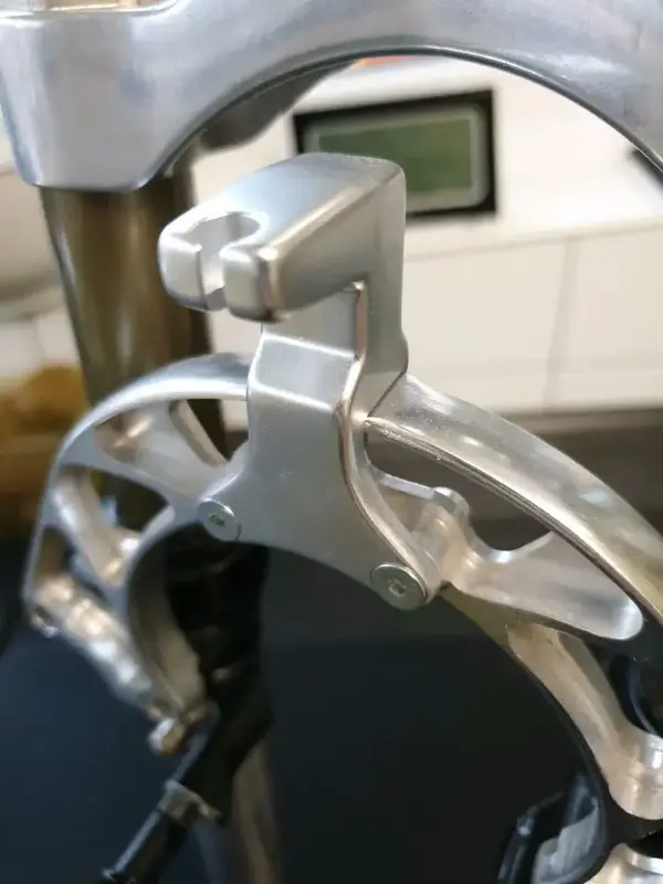

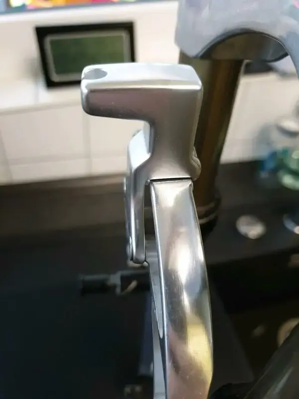

Hm, you say late 90's, that's before the Marzocchi m-arch types and there is a massive numbers of forks on the market, also fresh reproduced seals - no bricked NOS ones. 😏🤙
What is you problem with the canti hanger? Or use some kind of V-brakes and you don't need a canti hanger at all ...
Yeah, the m arch are a bit later but the early ones where the arch was a separate casting would fit with the rest of the bike ok I think. I’m not too strict on period correctness.

I have done excellent mirror polished ones and >150 in stock. 🖖🔧
