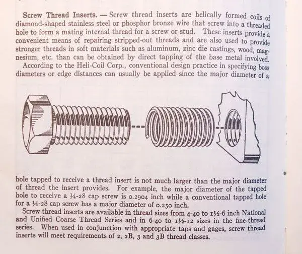

Helicoil cannot be used in high stress areas.
I'm sorry, but this is just not correct - there are plenty of "high stress" applications where a helicoil repair is stronger than the original fixing.
For example - the repair of stripped cylinder head stud threads in an aluminium block or barrel.
The limitations to the use of "Helicoil" inserts relate to the integrity of the surrounding material , ie- if by tapping out to a larger size to take the insert you reduce the strength of the component unacceptably, then this is an application where helicoiling may not be used.
Andy R, not that you aren't right, but it depends. For example a helicoil repaired pedal thread in a crank worked well but for few rides. If the load is parallel to the direction of threading, than its mostly ok, but it often causes problems when its not. Every could have its opinion and experience, so also I appreciate yours .
Here's what Machinery's Handbook has to say on the subject -

Agree with that, but there nothing about the direction of the load on a thread :wink: . OK, lets end the OT. If we could met, sitting with a cold beer, we certainly could come to terms 8) .
