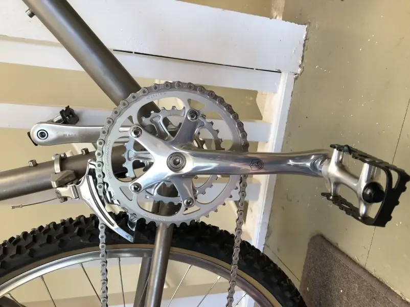

De Rosa MTB - full campag - rare as anything I’ve ever seen

Your right, it is confusing, and thanks for the info, ive two chainsets, one came Icarus equipped the other Record, and to me they look identical, i shall have to dig them out and have another look.
Both are lovely Carl. The Icarus' spider has 5 arms, whereas the Record only has 4 and uses the back of the crank arm as the 5th, if that makes sense.
Check out the pic's in the '93 catalogue link, you'll see the difference.
Thats it, with steel inner ring
