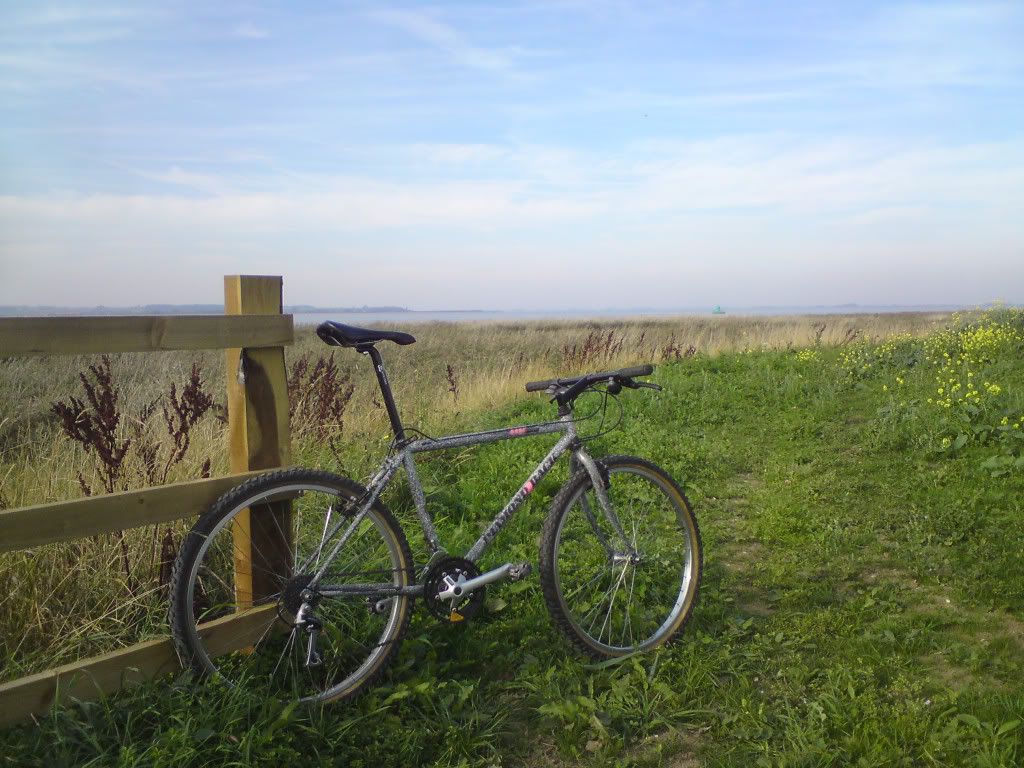

Is this the one :oops:
I had one BITD from new, was a cool bike. It could be an 89 model now that I think about when it was :lol:
