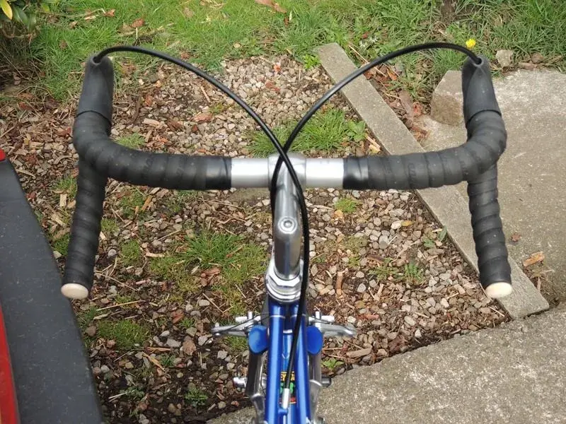

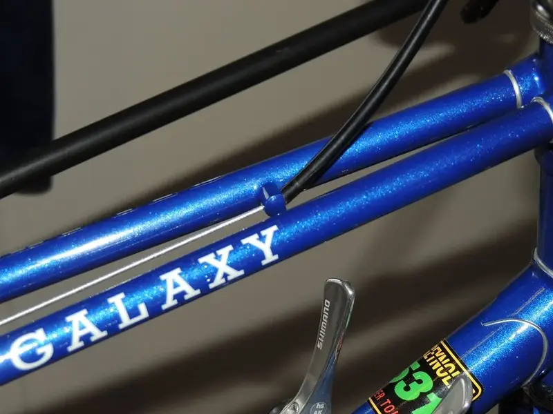

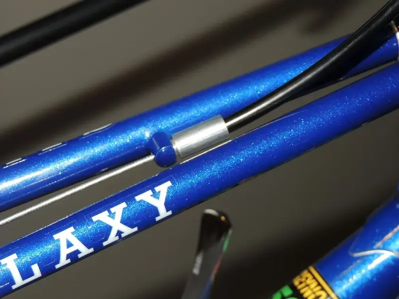

Whilst cabling up the brakes I found this 'arrangement' which I found unsatisfactory. The cable 'outer' doesn't sit nicely into the braze on, and because it is coming down over the handlebars, there is quite a kink in the cable.
If I put a ferrule on the cable it wouldn't fit into the braze on at all so I decided to make a 'reducing ferrule'. I am fortunate to own a small Myford lathe (40th Birthday present to myself!), so I found a small block of alloy and turned one to suit the job. I think it looks much more satisfactory, and it eases the cable round the corner.

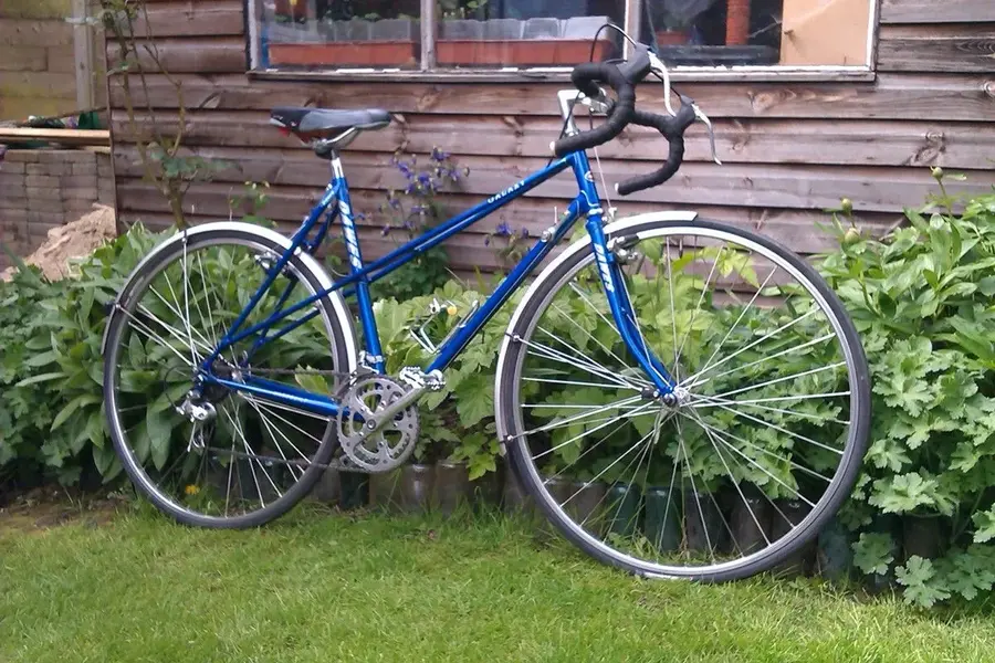

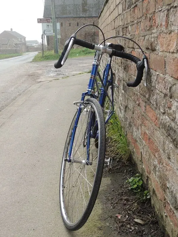

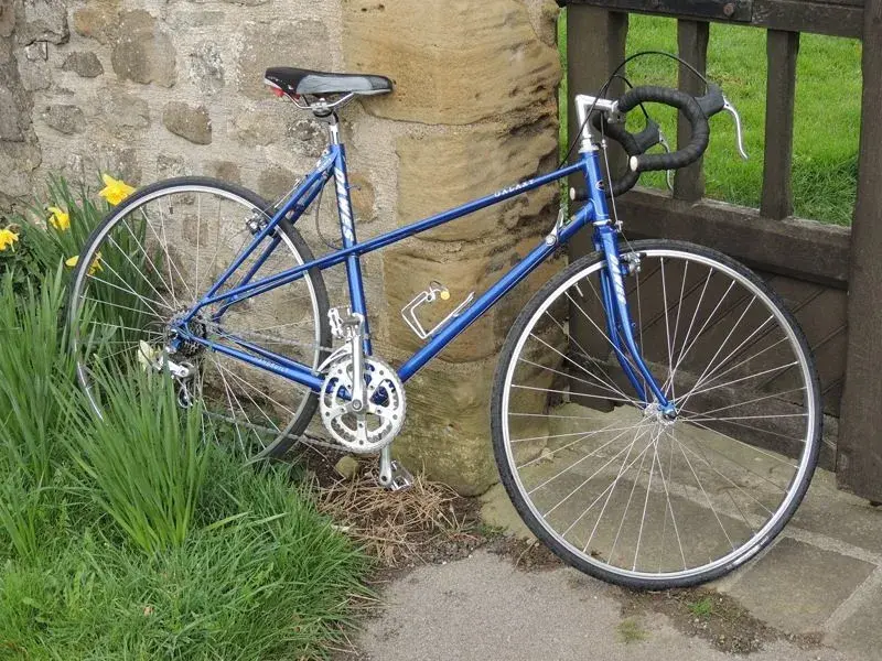

Here are a few pics of the bike out on it's test ride. It is now in use by my wife, but at some point I need to refit the rear pannier rack and mudguards, and track down a pump that will fit.
Apologies for the non period saddle - it is a Specialized ladies saddle, which she finds very comfortable. One day she might 'wear in' a new Brooks.

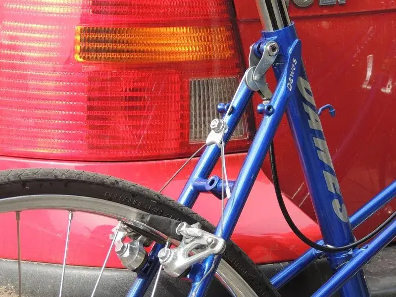

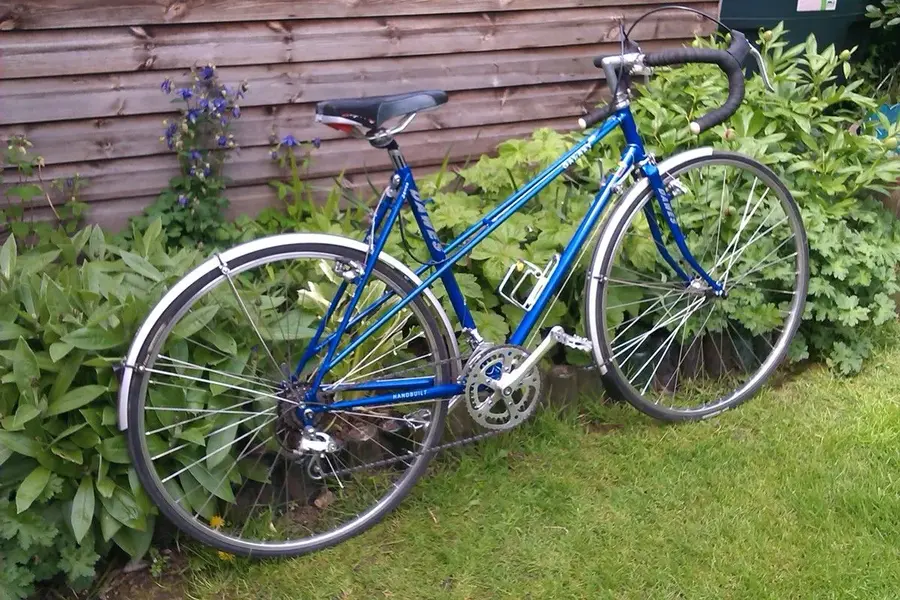

A couple of hundred miles down the road now, I have finally got the guards fitted but I am holding off on the rack until I find someone to do the weld repair for me.
