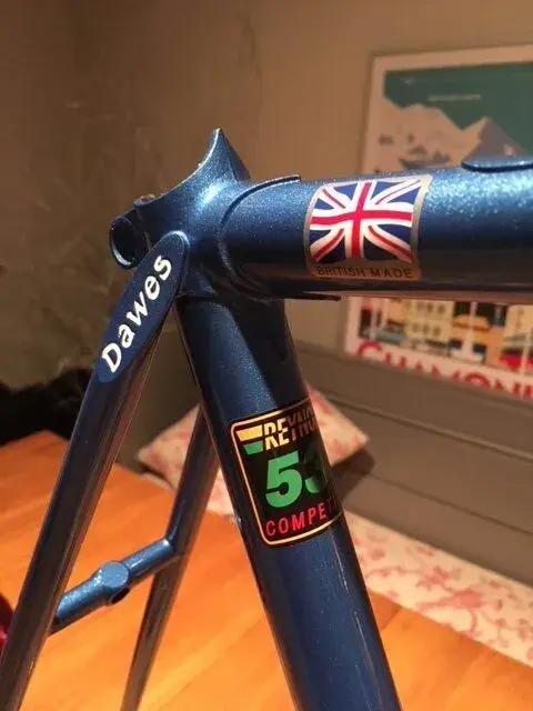

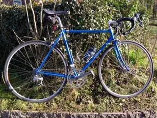

Ok, so no replies but here it is again with a new paint job and some changed parts....Clearly not a classic but a lovely smooth ride and very different to my carbon and alu bikes. In fact, almost more enjoyable...I must be getting old!
Cheers. Ellis Briggs in Shipley. Photos really don’t do it justice.

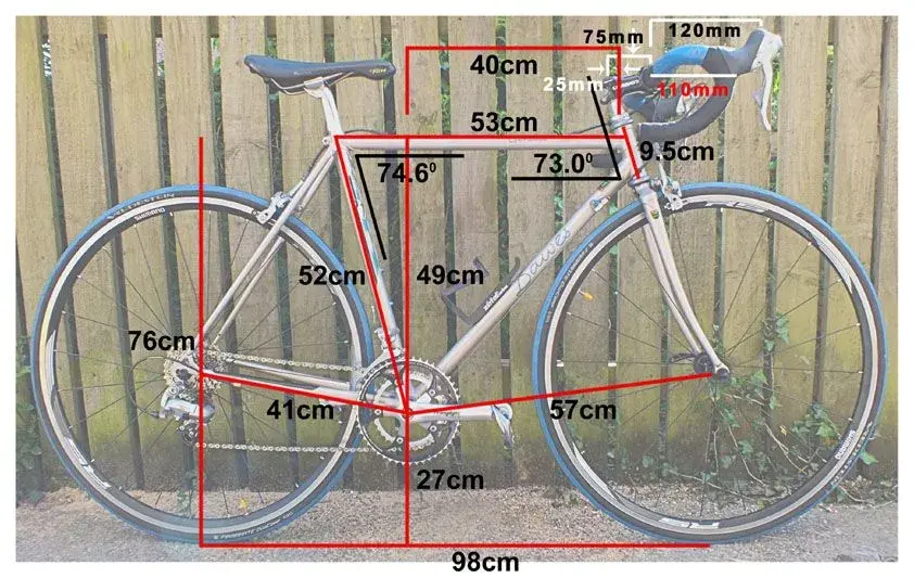

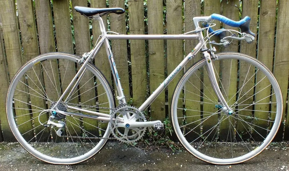

Dawes Genisis 1995.
Colour: champagne.
Frame set: Reynolds 531 Competition, Mn Mo butted tubing throughtout. Investment cast seat lug and crown. 531 forks.
Original groupset: Shimano Exage 400EX, 14 speed SIS down tube levers (right indexed, left friction), SLR alloy brakes and aero brake levers.
Wheelset: Shimano Exage Q/R hubs, rear 130mm OND, 7 speed freehub, front 100mm OND. SX100 anodised eyeletted alloy rims, stainless spokes straight gauge. Swallow Blizzard 700 x 22c tyres.
Available sizes: 51/54/57/60/63cm
Retail price: £450
Note: The 1994 model with the same spec as above was named 'Impulse'.

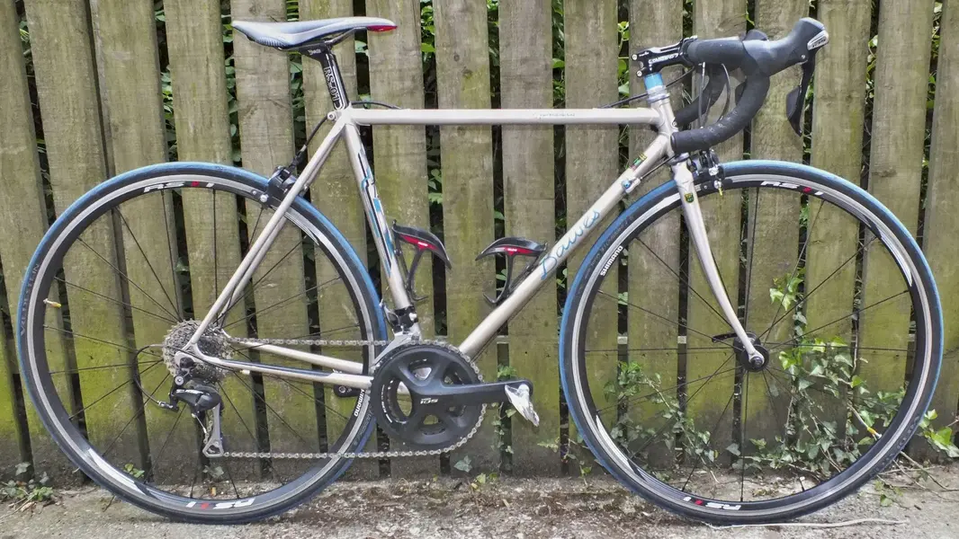

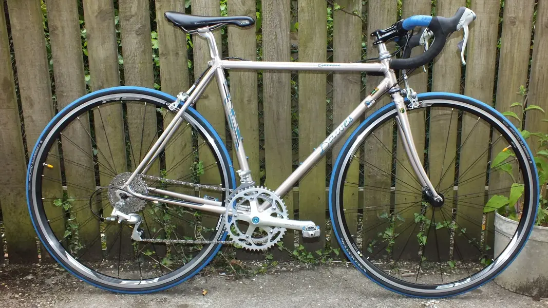

Bought mine when I worked in Halfords (51cm). At some point I picked up the Shimano 105SC 8 speed STI complete groupset (everything from hubs to headset) and upgraded the wheels (custom built 1056 rear and 1055 front hubs laced in to Mavic CPX 12, 32 hole rims, DT Swiss D/B spokes). Still use the frameset to this day wearing the Shimano 105 R5800 groupo. In fact I still have all the old 105 stuff and the wheelset. I don't throw many bike bits away....

So little interest in these machines. Don't understand the desire to respray what is a very rare Dawes frame. The second example shows how good it can look.
