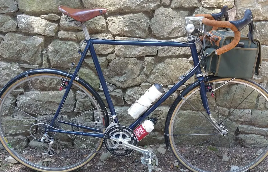

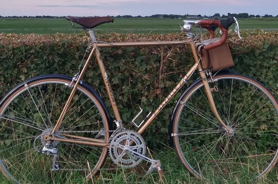

Two examples from my stable:
Campagnolo Chorus 9-speed shifters with a 5-speed Shimano rear cluster and a double up front, in a 120mm rear triangle:
Athena 11-speed shifters with a 9-speed Shimano rear cluster, shortened to 8 cogs to fit the 126mm space between the rear dropouts. And a triple chain set:
Superfluous clicks of the right shifter are blocked by the RD limit screw. The Campag left shifters use a ratcheting system rather than indexing, and they will shift pretty much any FD.
