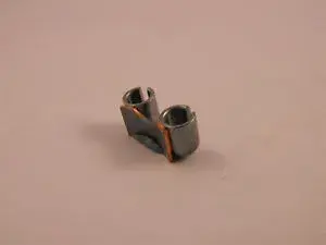

I have tried to upload a picture of the frame - but there is a very low file limit, and a block on PDFs, so it isn't easy, and if I get below 512k, it can't read the JPG correctly.
I am amazed on an expert website that no-one has heard of braze on components. I have managed to upload and attach a component readily available on ebay.
Even without brazing, there are bolt on equivalents, which I have used where I haven't had to strip the frame, but given that I have just had it shotblasted, no problem.
Brazing has to be used for any minor repairs if a powder coat finish
is to be used.

Of course we have "heard" of braze on components, but I'm sure most of us don't consider it normal to grind them off and braze them back on as and when we feel like it, which is what you appear to be suggesting. (Apologies if I have misread this.) Most of us are hobbiests, not necessarily experts, based in garages and sheds and are not generally equipped or skilled to do brazing at home.
I think we would leave a component brazed on if we didn't need it, even if the frame was stripped for a refinish, because it would be unnecessary expense to put it back on later.
In my case the downtube bosses were THE place to fit the cable adjusters when I moved to barcons on one bike and brifters on another.

I too have 'heard' of braze ons. I've built up many racing and touring frames, worked in bikeshops etc and can even braze by trade myself. Though this is the first time I think I've ever heard of someone suggesting that you should remove and refix braze on fittings as and when you need them. You may do it once or twice but the tubes will eventually weaken due to the heat and will become a weak spot. If inexperienced with brazing then the chances of doing it repeatedly without blowing through a tube is very remote.
I am assuming its to make the frame singlespeed or fixie otherwise were the boss's damaged?
If not, then why remove the shifter boss's when guides just fit over them.
I'm certainly not an expert but I've been around bikes and built bikes up since
I was kid so this is just my opinion, except the brazing part, I wouldn't say an expert but it was part of my trade for a lot of years.

I too have been building bikes for around 40 years. There are only so many bikes you can keep, so frames pass through my hands just once, normally.
The idea of constant changes is ridiculous. I have removed (by grinding) the unwanted stubs which are lateral to the downtube, and am installing guides which are below the downtube in two places, which are unrelated to the stubs, anyway.
Equipment for brazing is dead cheap - mine cost £14.00 from Wickes. It works on a mixed gas canister.
Anyway, you can always buy bolt-ons.
I can't see the point of leaving the stubs - they are dangerous to leave uncovered by levers.
This particular bike is going to have straight handlebars rather than racing bars - the recipient does like racing handlebars - ideally suited to SIS gear levers mounted on them.

I think people are just curious why you just didn't just plonk on some cable stops to the bosses already there as it saves all that grinding and brazing...
