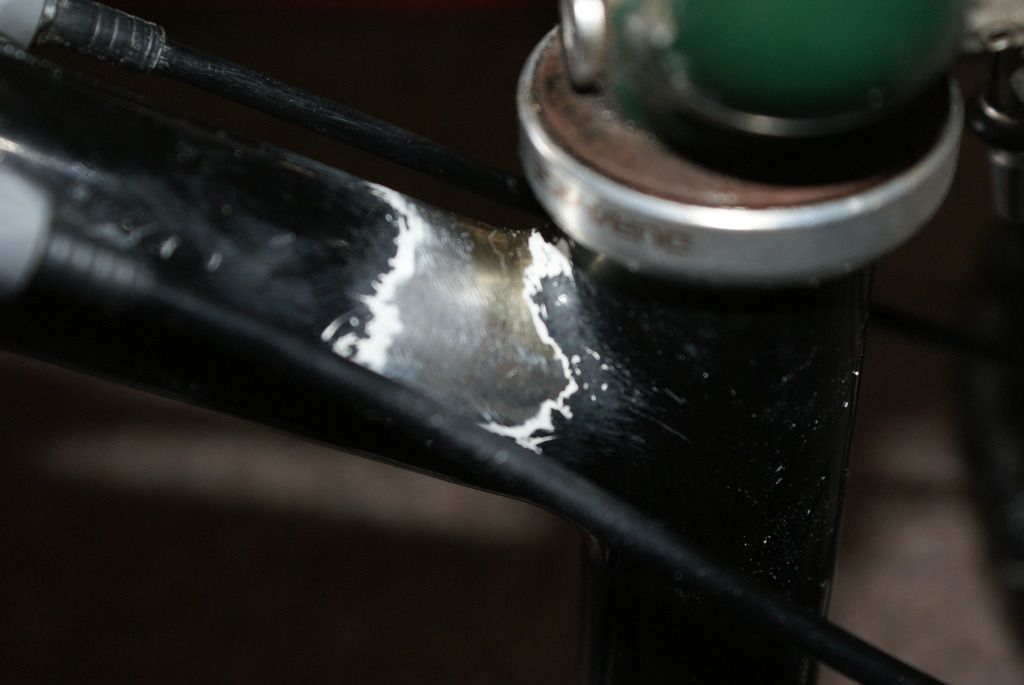

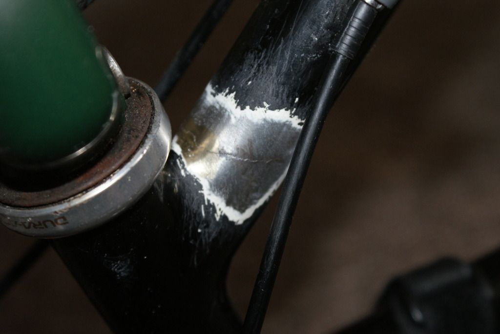

Could have a new down tube fitted? (About £80) Depends on how much you value her? While your' at it, could add the braze on's too, as it will need a repaint.
May seem pricey, but when you consider what the equivalent would cost to build today?
Been quoted around £160 to have the above done with an 853 tube, minus respray ofcourse. Problem is my build doesn't even have the original forks. Managed to find the Dave Lloyd ones that I fitted for a good price but they are not off a Concept 90 - earlier I'd say, 80s maybe. The rake is certainly different to the ones that should be on there. Been back on my Graham Weigh (pictured earlier) and it felt nice to ride again. Have fitted some Nitto Noodles and shorter Nitto stem which have improved the fit for me. And by god, it was nice to pedal standard (53/39) again after my experiment with a compact on the Dave Lloyd. Rhetorical question: the Concept 90 is unsafe to ride now I take it?

Bob Jackson's and Woodrups from Leeds charge around £80 for a new down tube and their work is pretty good. However what about contacting Dave Lloyd for a repair?
I tried contacting Dave twice when I originally got the frame but received no response I'm afraid. Thanks for the tips re: other repairers/frame builders. Not sure if it's generally more expensive for brazed frames though in general. I think the Graham Weighs are nice. Mine's Reynolds 853. Just looking at the picture of my Raleigh Triathlon there again. Gutted man :cry: Kind of went from three road bikes to one in space of a few months. Them's the 'breaks' I suppose :lol:
