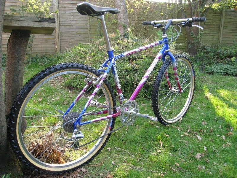

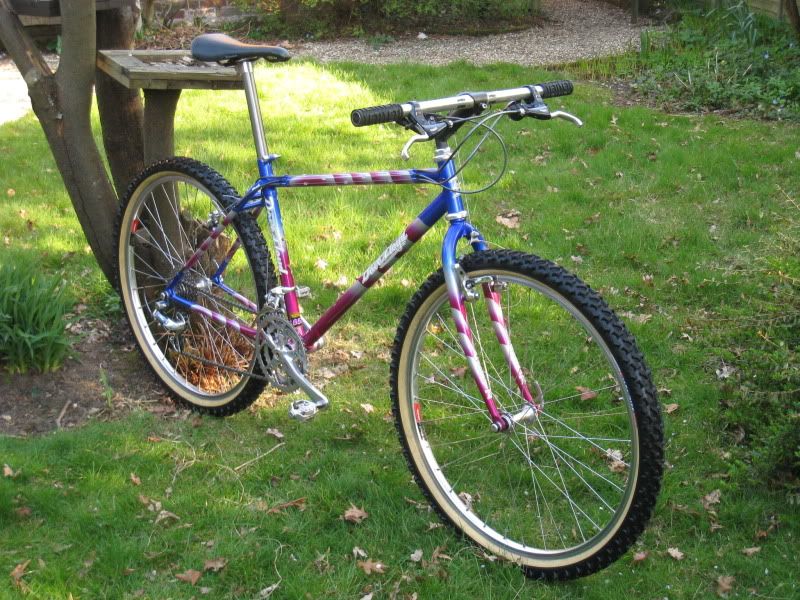

Here you go chaps :)
Managed to build it up today. Not finished though as I'm waiting for the 'new' stem, some ODi Attack grips and errr, a bit of cable tidying probably ;)
Spec
Frame: Dave Lloyd 'Beez Neez'
Fork: Dave Lloyd
Headset: Dura-ace
Stem: Will be Tange prestige custom painetd
Handlebar: Answer Hyperlite
Grips: Will be ODi Attack
Brakes: M900
Brake Pads: xtr
Brake Cables: xtr
Brake Levers: M900
Shifters: M900
Front Derailleur: M900
Rear Derailleur: M910
Derailleur Cables: xtr
Cassette: M900
Chain: HG-91
Cranks: M900
Crank Bolts: Titanium
Chainrings: Shimano 46,36,26
Chainring bolts:
Bottom Bracket: UN-91
Pedals: Onza HO Ti
Hub Skewers: M900
Rims: Araya 395 XC Team
Hubs: M900
Nipples: Alloy
Spokes: DB Stainless
Tyres: Ritchey Alpha/Omega Bite
Tubes: Yes
Saddle: Flite Ti
Seatpost:American Classic titanium - will be xtr
Seatpost Binder: Bolt
Cheers
And me.........Well done Martin, i bet its killing you not having the stem back yet :oops: , but it will be worth the wait, I managed to order Odi attack grips today, Ison have plenty in stock, if you give them a ring, thell tell you who are closest to you, and ensure they have stock for you, (sorry about that bud... :oops: ).
Billys are pretty good to deal with, ( although they do have a minimum order for free carriage).
Can i ask what width tyres did you end up running....? And im intrigued about the weight also...? when your stems fitted, could you let me know.
Im buzzing mate, lovely bike, quality craftmanship, and stunning paint to show off that sexy slim tubing and fillets.
We need close up pics...... 8)
