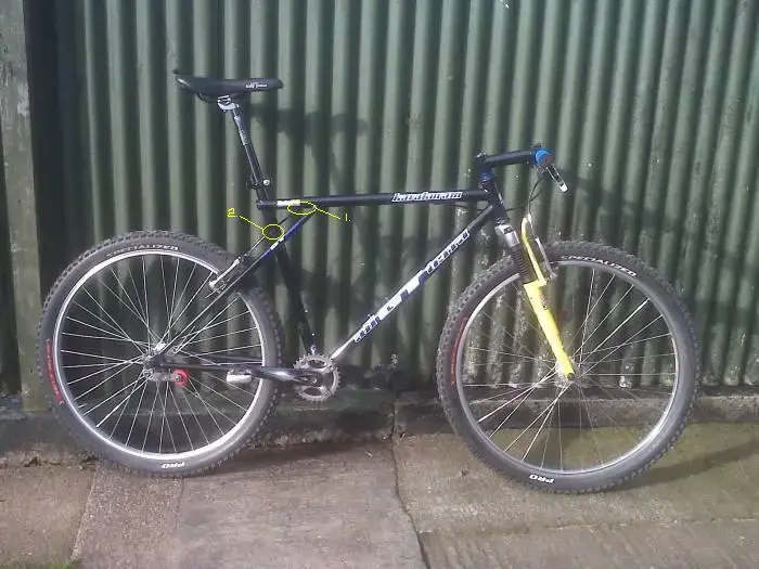

Here is the cable routing on my 94 Karakoram, which I am running LX V's on for the moment. Cantis will follow, to keep it period correct.
1) Brake cable outer routes the cable straight down to the V's.
2) Canti guide not it use.
However, when using cantis you'll need to use a cable outer to route the cable from point 1) to 2) otherwise the bare cable will eventually hacksaw through your frame! :lol:
