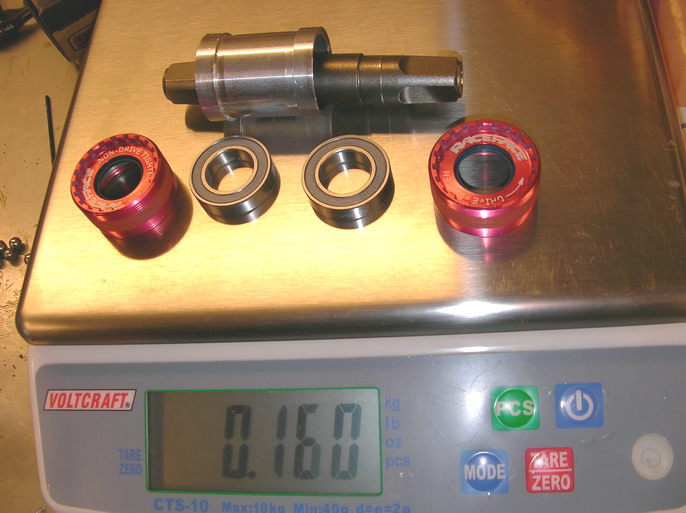

Darn! Race Face BB cup thread direction wrong!
Just popped to the CRC website,
http://www.chainreactioncycles.com/Mode ... odelID=305
Now that clears things up.
RH does not mean Right Hand Side, but Right Hand thread aka Left hand side/none drive side.
LH would be what you need written on it for
Only the Canadians could think of making that one complicated :twisted:
Try one of your dealers
http://raceface.com/dealers-distributors/dealer-search/ to see if you can get it cheaper if needed.
Here's what the matching pair look like (for the one on the left in your picture)
wynne":3melngct said:
I have the same RF taperlock bb and the cups are marked exactly the same as yours and fitted into my bb shell no problem, though they were a little stiff going in due to the thread lock on the cups.
I'm pretty sure RF only made an English threaded version of this so it makes me think there might be something going on with your bb shell.
Rich
nothing to do with the thread lock. are you sure they are marked EXACTLY the same? now knowing what's wrong, the arrows clearly indicate which way it should thread into the frame BB shell. they should be OPPOSITE directions as RH is Right Hand thread for the non-drive and LH should be Left Hand thread for the drive side. it is confusing as i thought RH on the one cup meant Right Hand side of the BB when i first got it, but clearly it is NOT the case.
as people have stated, it looks to be two different cup revisions of the non drive Right Hand thread i've been given.
and as stated, both cups thread into the non-drive side. as well i tried TWO other BBs to be sure it wasn't a bb shell threading issue. a Shimano UN72 and a MRC Ti BB and both work fine. both weren't the axle lengths needed for the crankset i wanted to use.
