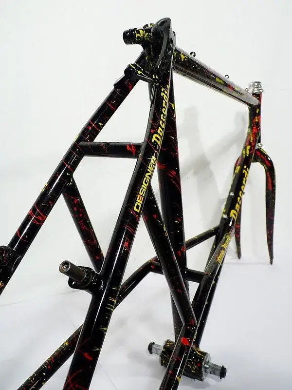

Anyway, back to my road bike interests where I have formed an affinity with the somewhat niche Italian brand Daccordi. Interest turns into obsession and I now have one or two or ……. well you get the idea. Which explains why when the following turned up on E-bay, Germany – I just had to have it.

So while I wait for a large box to arrive from Deutschland it gives me time to consider what I am going to do with it when it arrives.
What theme is the build going to take and where am I going to get the components ? This is where you guys come in to hold the hand of a roadie as he does his first mtb frame build. I need your suggestions and to check my ideas make sense.

Firstly, although I don't particularly like e-stays, that frame ..... wow! I'm a sucker for Italian things and I like the splatter paint job.
Campagnolo OR would be a great match, but I can see the hesitation given availability and prices. If you decided to go down the Shimano route, given you have one built up with LX and one with DX you could build this up with XT or even XTR which was introduced as the top range in 1992. XT is 7 speed, so you could start off using the Karokoram Elite wheels if you wanted, whereas the XTR is 8 speed, so that wouldn't be as well suited for mixing and matching, though some people are happy with the shifting they get from mixing (spacing is slightly different, 5.0mm for 7 speed and 4.8mm for 8 speed, but the float in the top jockey wheel on Shimano derailleurs gives some leeway).

“E” frame – is that because the tubes look a bit like an E or some other reason ? What was seen as the advantage of this design ? In the photos of your bike built up I can see the chain wheels are higher than on a normal bike so was it to give greater ground clearance ?
Looking at the photos of the Dacccordi (not arrived yet) the relationship between the bottom bracket and the rear wheel drop out seems reasonably conventional. I shall be quite happy if it proves so as I do not want inside leg reaching the ground issues !
You were so fortunate to get the XT components along with the frame. I shall have to find at least front & rear derailleurs and shifters/brake levers. A nice wheel set of the period would be great too. I may consider going off piste for some components as I may already have some bits I can use. Of that more later !
E-stay stands for elevated-stay. I'm sure other people can better inform you about the pros and cons of that design, but primarily it prevents the chain having to go around the chain stays, preventing chain suck and generally making life easier. It also aids a shorter wheel base, but does lead to a bit more flexing at the bottom bracket.

Great excitement ! The box from Germany arrived today courtesy of Deutsche Post and Parcel Force, according to the labels on the box. I don’t know when it was actually sent but I ordered it last Tuesday afternoon and it arrived at Noon today so 7 days. I think that is quite good for £30.

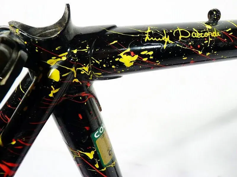

I could hear the frame rattling about in the box but it was well bubble wrapped and pipe lagged and seems in good health. Paint work in really nice condition; I give it 9 out of 10 with a few chips that a bit of black paint will put right. That is the beauty of black bikes I find, really easy to touch up and they shine beautifully when buffed up.

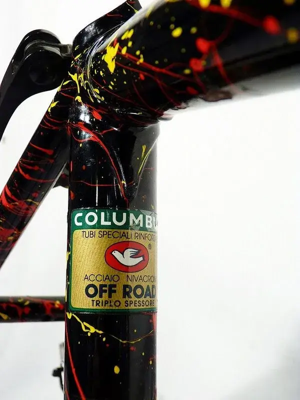

My initial thoughts were that the frame seemed a bit heavy but some work on the bathroom scales came up with a figure of about 8 ½ lbs which includes the Stronglight headset, Shimano BB, seat pin clamp and 2 pairs of bottle cage bolts, so not too bad bearing in mind there are quite a few extra tubes compared to a conventional diamond frame. Both frame and forks are Columbus Steel Off Road, Reinforced and Triple Butted. Because of its design the frame is a strange mixture of lugs and welding. The fork crown is lugged as is the head tube and seat cluster but below these all is welded, quite beautifully finished with none of the caterpillars of weld you find on aluminium tubes.
