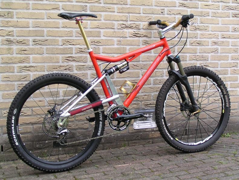

I had a Gossamer CX double with 36-46 om my Heckler with no issues that I can remember. Frankenbike build that worked remarkably well for fast XC riding:

Easier if you're running square taper - I had an Octalink on the Kilauea in the above pic and the longest axle didn't quite clear the chainstay. A gentle application of the rubber covered handle of my claw hammer sorted that one... :shock:

On the basis that that's what's fitted in the pic of my bike (my daughters' now actually...) above - yes 8)
