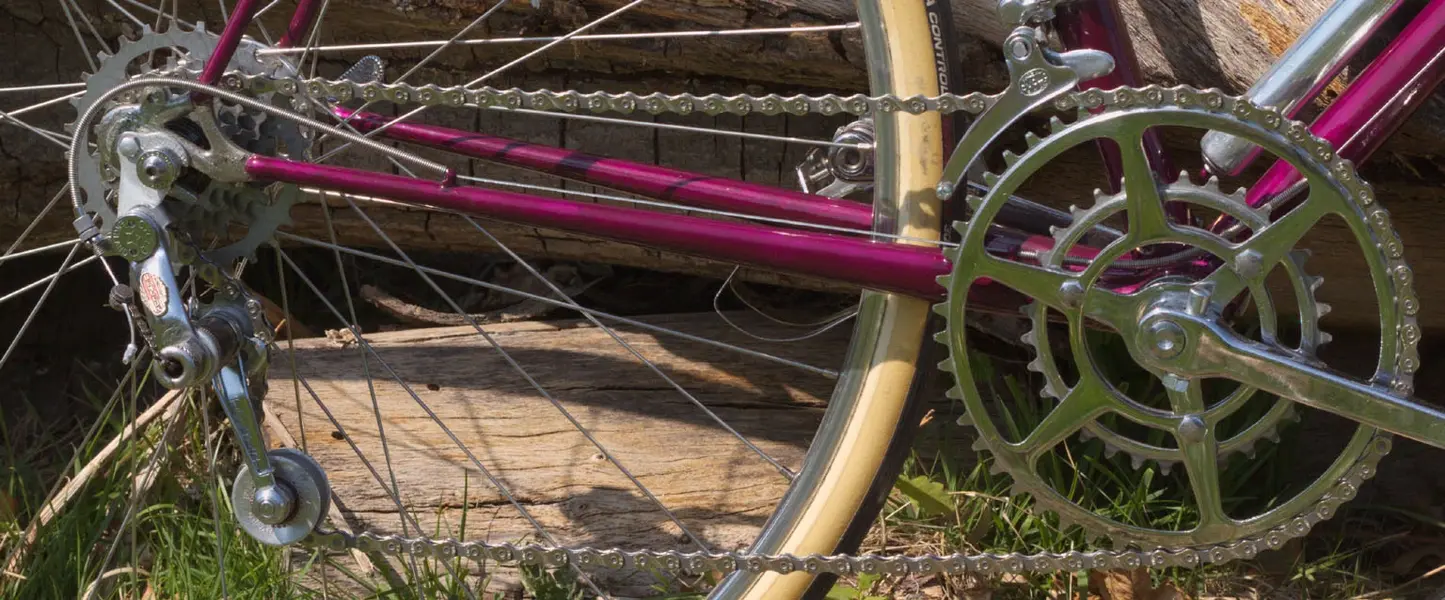

I’ve just bought (on Gumtree) a pretty Viking Ian Steel Model. (Separate thread later)
It’s the first bike I’ve owned with the Cyclo dropout intact - have a Hetchins where a previous owner had hack(saw)ed the derailleur attachment part…
No doubt because the cranked hanger meant that rear mechs, available at the time of butchering, wouldn’t have reached the lowest gear cog.

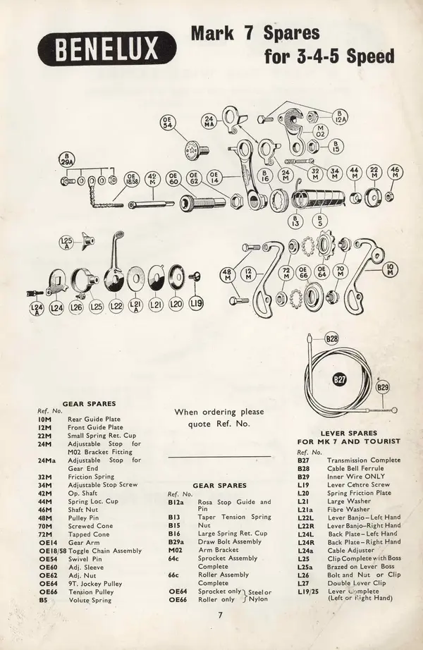

I presume ‘modern’ mechs for 8 or more gears would have enough movement(?)
However, the threading on the dropout is 1950’s (British only?) and not the current (universal?) standard.

I'm not sure what you're trying to do. Are you wanting to go from the 5-speed on there to a 6-speed with a 28T lowest gear? If so, I agree, it looks like the Mk7 will be reluctant to do that.
Not sure either (apart from producing a bike I’ll like riding)
All part of the dilemma!
Mech is original and seems in good nick
48/22 just not ‘sensible’ (I don’t live anywhere ‘flat’!)
I do have a 40t ring that would fit (and other chainsets).
Forks not original (no sign of damage to frame). Wheels not original either so it’s not about preservation or restoration to some variety of original.
Viking catalogues show several options for each model and sold framesets, so no chance of ‘as sold originally’.
