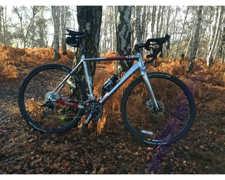

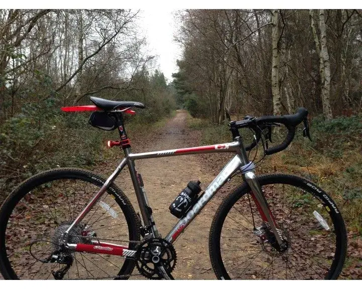

The bike: Boardman Team CX 2014 spec.
My purchase was a 2014 spec Boardman Team in the large 55.5cm size. I'm right at the lower end of the size range for my height but I reasoned a taller head-tube was the way to go for comfort. Upon collection it was clear the seller had done very, very few miles on the bike - 150 miles could well be true. Also, he had the purchase receipt to show for it and the shop stickers and bar-codes were still on the bike, lending more weight to the statement. Once I got it home though, the assembly (not build) quality was shocking. The spanner monkeys had done a terrible job. I won't bore you with the details, but one by one I ironed them out over a week of evenings and swapped the following components out. Here's what & why:

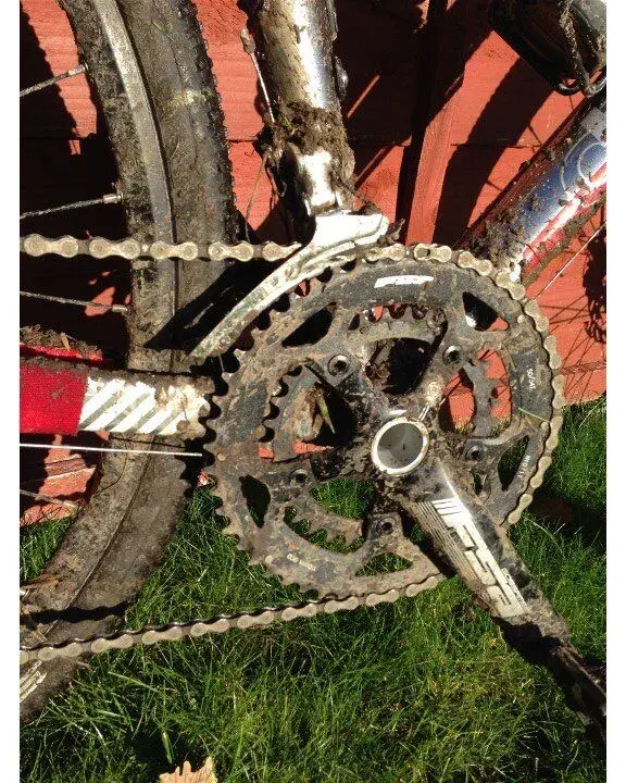

After a quick foray down the side of the canal to get to the hills, I was in my stride. The compact chainset is hampered by the Microshift front mech, which feels heavy at the lever and despite repeated adjustment continues to drag at the upper end of the range. Thus I spent all the off-road bits spinning in the inner ring and on-road in the outer. This was a pain and was so frustrating I ordered a discounted SRAM one from Chain Reaction Cycles when I got home - I did have another half-hour go at adjusting the front mech first though!

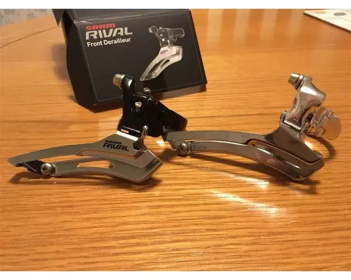

Well my SRAM Rival front mech arrived today and I've fitted it... I'm not happy. The finish and overall feel of quality is nowhere near as good as Shimano, in fact the finish on the Microshift unit it replaced was actually better. :evil:
The SRAM derailleur has a stronger spring than the Microshift one, so the lever feel is actually heavier! On top of that, as I was fiddling with the set-up the lever - SRAM Apex double-tap, got heavier and heavier and more difficult to shift down. I silicone lubed all the pivot points on the mech (plastic bushes hence silicone) and the cable as it enters the cable outer and the under bottom bracket guide. I finally peeled back the hoods, silicone-lubed the plastic bits, put a tiny smear of LM grease on the moving steel parts I could see and two small drips of Finish Line Wet Lube on the moving metal parts I couldn't reach with the grease. After a few minutes to work themselves in, the lubes collectively improved the situation, but it is nowhere near as smooth as my 2009 Shimano 105 shifters that have been used in all weathers with no maintenance whatsoever. In short, my SRAM set-up is a disappointment. :(
Aside from the heavy leaver feel, the shifting is much better than the Microshift. It shifts up much, much quicker, and I can use all but the two low-high gears combinations (cross-chaining). It only just rubs on high-high 50-11 under load, which is way better than before where at least four of the highest gears rubbed the cage.
To cap all that off, the lever sweep to engage each gear is further than Shimano equivalents, so if you're reading this and have small hands, be warned you may find SRAM shifting more difficult than Shimano. :x

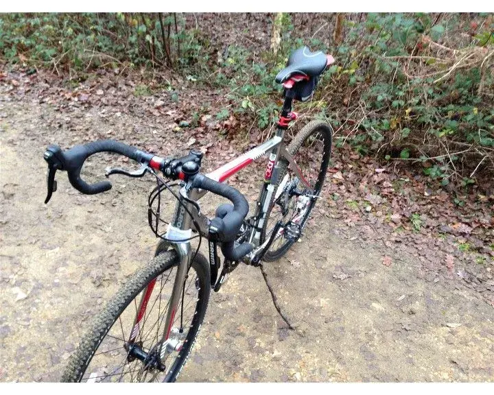

Nice write up, I'm kind of in to this and flirt with MTB drop bar builds.
Interesting why you went for a narrower bar though, or was it something to do with the hook shape too?
Otherwise, that spoke protector really does need to come off.
I have my other road bike with a 42cm bar and I know this is comfy for hours so I've ordered the Easton 42cm to replace the Boardman 44cm. The hoods do feel a long way out - I think this is partly the shape of the bars and partly not being used to SRAM levers. The nose of the saddle to centre of the handlebars measurement is actually 1cm shorter on the Boardman than my Giant, but I still feels a stretch which I put down to the aforementioned reasons and I hope can be addressed with the new bars.

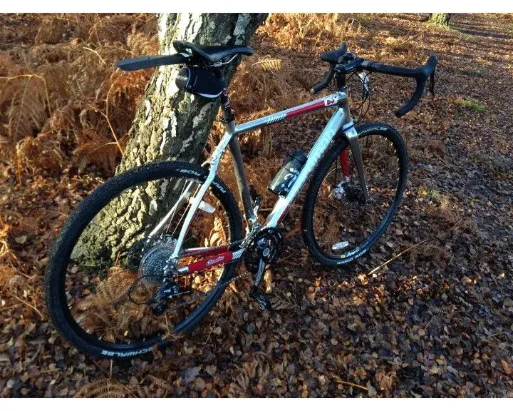

I've done a bit more riding on the Boardman... I still love it, but I'm finding its limits. For example, it is only as good as a rigid MTB for vibration but with grip tape not rubber/foam grips, so if you ride is mostly off-road, you might as well take an mtb! The current Schwalbe Rapid Rob tyres are not confidence inspiring on wet tarmac when lent over and having ridden with some Schwalbe G-Ones https://www.schwalbe.com/gb/road-reader ... round.html on a mate's bike it is clear things could be improved on-road at the expense of off-road grip. These may be a future purchase, although they are not cheap so I'll sell some garage clutter first.
I rode ~4 hours with a mate on a Charge Plug 5 http://www.wiggle.co.uk/charge-plug-5-2015/ in Tange Prestige steel with SRAM Rival hydraulic brakes. I rode the Plug as well as the Boardman, and the Boardman is definitely more 'racy' in terms of feel with a more aggressive riding position. The SRAM Rival gears were no different from my Apex bits and unbelievably the hydraulic brakes were actually worse than my Avid BB5s. I had to tell my mate to go easy on my bike having ridden his as my brakes had way more initial bike - easily demonstrated by my mate still locking the back wheel at junctions despite the warning!
We rode on an off road, the Charge being better on (tyres have a part in this) and the Boardman better off. Heading to Peaslake the Plug got a puncture and being tubless, said mate wasn't carrying a tube :facepalm: I lent him one and we stopped in Peaslake's Pedal and Spoke store for sealant - which was unsuccessful as the tyre wouldn't seat, and then some tubes. Heading onto the trails, the Boardman felt much better suited to more technical off-road and we even took in an mtb trail or two, albeit very slowly :lol:
Riding home on the Plug I concluded I liked my Boardman better and although the bars are still too big (the Easton ones I bought were the wrong width) and the riding position not quite right yet, I reckon with some slicks I could probably do a light tour on it. I don't like my Dawes Galaxy to ride any distance so I've listed that on eBay and will use the Boardman instead as I have a rack that'll fit. I have purchased some 42cm Boardman bars on eBay for £5 (!) so when they arrive we'll try again.
