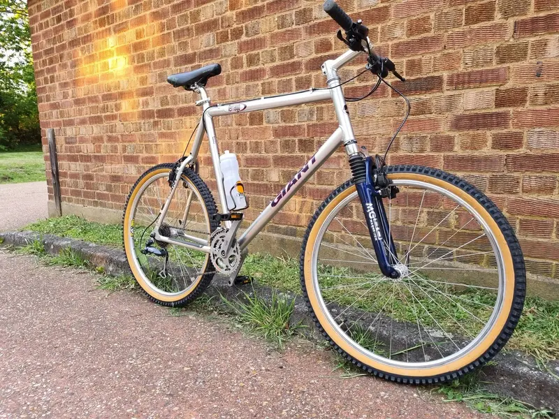

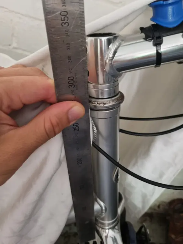

Is the headtube extraordinarily long or something here :? or are you trying tto make a small frame fit by having more of a stack, in which case isnt such a good idea, as i believe it becomes a bit iffy having too much steerer above the headset. Most manufacturers say 40 or 50mm.
I'm 6'3" and usually need as high as i can get, but even my frames which have always had the maximum length of headtube I never needed anything above 260mm total length
The headtube is very long indeed.. the frame size is 25.5 inches, so basically it's a giant Giant! Check the second pic (and yes, I know my headrace needs cleaning!) 😀

What about some sort of inset headset :? lots of modern headsets these days, could you find something of zero stack ?, could at least open up more options.
Thanks for the suggestion. I have just got off the phone to somebody at Sven Cycles in Weymouth and they have found a solution. I'm awaiting email confirmation, but they have a 1 1/8 steerer that is 400mm when uncut. Sorted :)
