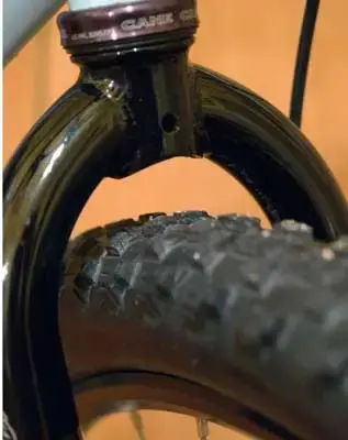

Is the 425mm measured to the bottom of the crown or top, where the bearing race sits? They do look a lot longer than 425mm.... :?
No, they'll be 425mm axle-crown. There's enough room in forks of that length to get a 29" wheel in, with something like a 2.35" tyre. Ι used some 425mm Salsa Cromotos with a 29" wheel and there was plenty of clearance.

Quite taken with these, just got a few more daft questions for you (or anyone else that feels like answering) if that's OK. 425 A-C is equivalent to a less than 80mm suspension fork, right? The frame I have in mind for them was designed for 100mm forks, so would these be too short? I don't really want the steering to be any quicker than it is with a 100mm sus fork. This A-C stuff makes my head spin.
As far as I know, a 80mm corrected suspension fork is 420mm and a 100mm is 440mm. this fork is 425mm. So I guess it could make Your steering quicker, but then again I think it's also something about the offset of the fork, I mean how long the fork go forward, so that if the front is lower but the wheeldistance is the same as with a 100mm fork, then the steering will be the same it will just be a litle lower at the front... Or is that something I spent the long winternights thinking about :(
