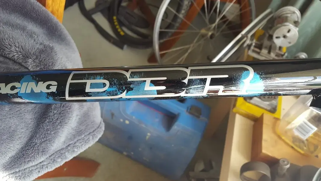

Well I can confirm Gil is the man not only for repro stuff but custom designs too
I estimate some 30 plus emails later we had the final proof on a custom set of decals.
These were predominantly cut from metallic silver colour vinyl but because of some fine detail a couple of decals need to be printed.
Kudos to you Gil for your pain and suffering but in the end this build was not possible without you!

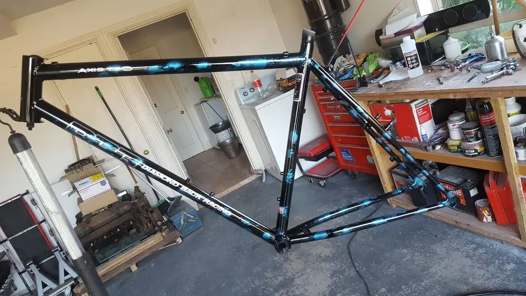

So here is the frame paint scheme:
Super Black base
Turquois base with blow through effect, custom matched colour to M4 anodising (dam difficult to match)
Custom decals applied
Clear top coats
All applied in the required 8hrs start to finish.

The idea was to create an illusion of the "wet" turquoise paint from the M4 to splash up against the frame when at speed. Hence the is no splash marks near the head set tube or on top of the top tube and the paint was shot from fork in a "radial type fashion". Also when the frame is viewed from the rear almost no turquois paint can be seen.
The plan is to paint the brake boosters and water bolt cages the same turquoise base coat with then clear top coat. So I am not quite done with the spray gun just yet.
The silver decals and turquoise metallic paint really pop in the sunlight.

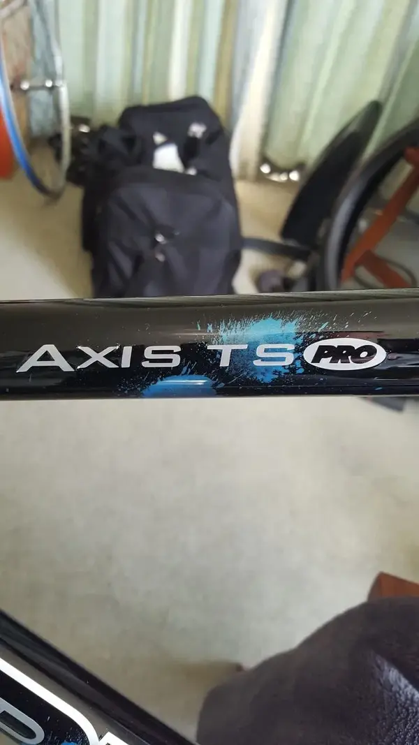

So this is custom/prototype model is an Axis TS (Axis Team Steel)

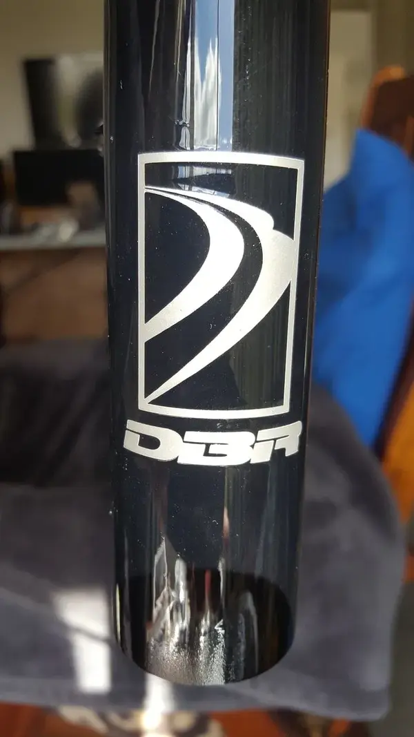

Close ups of Gil's handy work on the seat tube decals to follow.

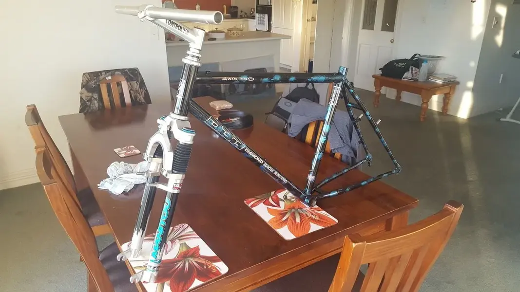

The head set is a NOS Shimano XTR M901 I got from a seller in Germany.

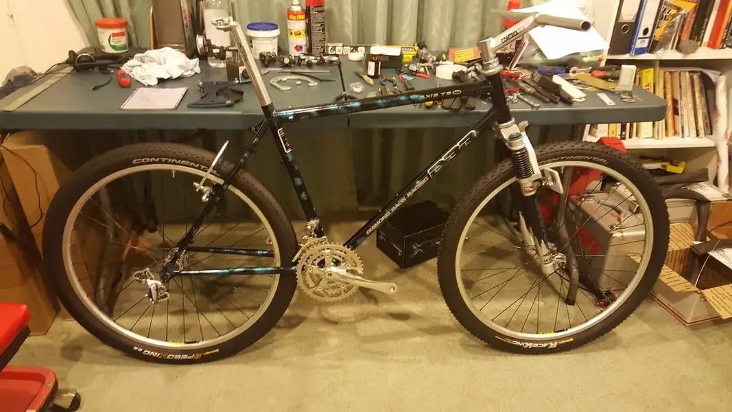

Build sheet as follows now that the build is close to complete:
Frame: Originally 94 Diamondback Topanga – customised, weight 2.6kg
Fork: Answer Manitou 4 with extension kit
Headset: XTR M901 1 1/8 “
Stem: Answer A-tac
Handlebar: Answer Hyperlite 5 deg
Grips: Answer logo, clear
Barends: N/A
Brakes: XTR M900 SLR
Brake Pads: Koolstop black
Brake Cables: Grey XTR SLR
Cantilever cable hangers: XTR
Brake Levers: XTR M910
Brake Boosters: Chasertech aluminium
Shifters: XTR M910
Front Derailleur: XTR M900
Rear Derailleur: XTR M910 with Rollamajig
Derailleur Cables: Grey XTR SIS SP41
Cassette: XTR M900
Chain: XTR HG91
Cranks: XTR M900
Crank Bolts: XTR
Chainrings: XTR
Chainring bolts: XTR
Bottom Bracket: XTR UN91
Pedals: Purchased new in 96 (can’t recall brand has CF wrap) with Lake shoes
Hub Skewers: XTR M910
Rims: Mavic 238
Hubs: XTR M910
Nipples: DT Swiss aluminium
Spokes: DT Swiss 2.0/1.8 Champion Black
Tyres: Panaracer Dart and Smoke classic black wall / Continental Race King and Speed King
Tubes: Continental light
Saddle: Selle Italia Flight Flow Ti
Seatpost: XTR M910
Seatpost Binder: Avenir
Water bottle cages: Avenir
Cycling computer: Avenir A1, 94 vintage and still working
Weight: Take a guess! Will weigh in when complete.
