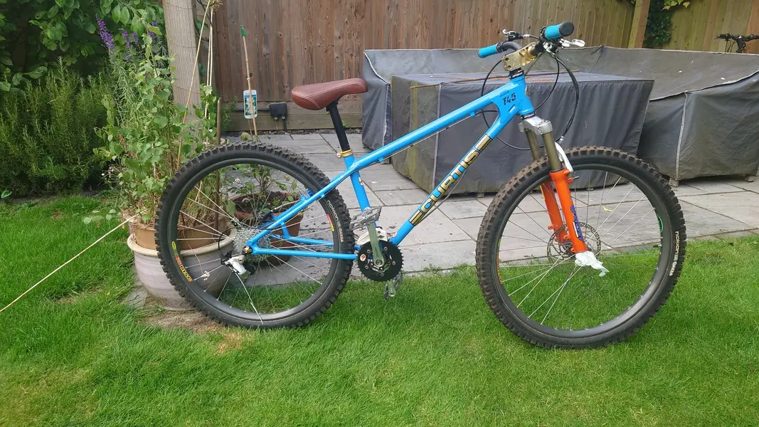

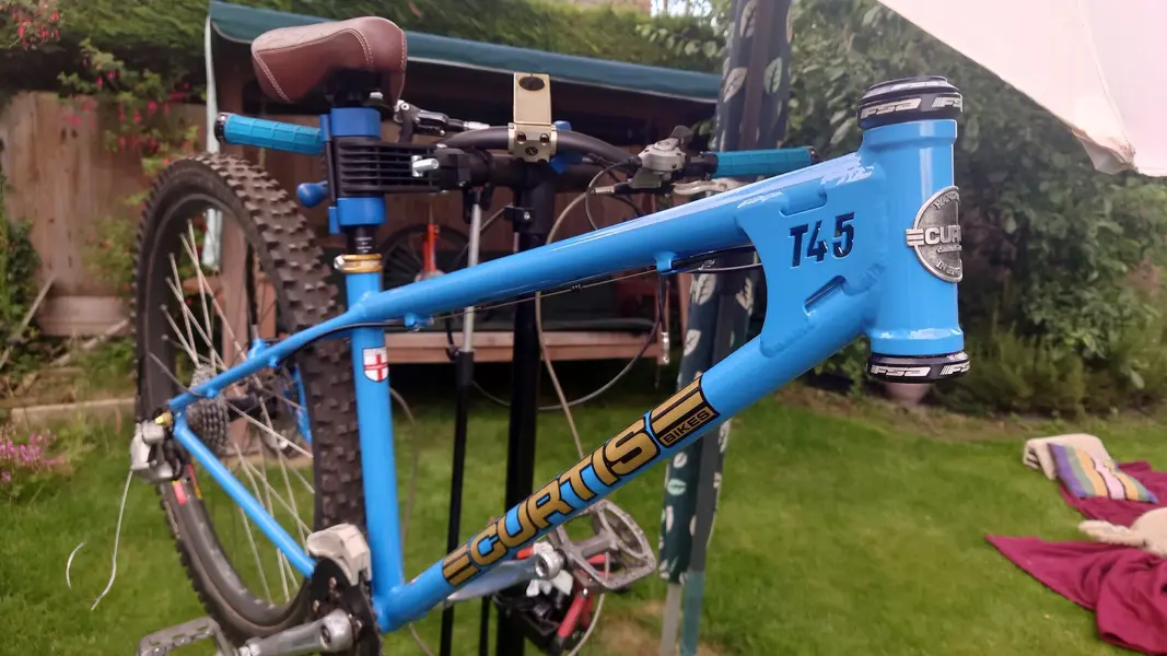

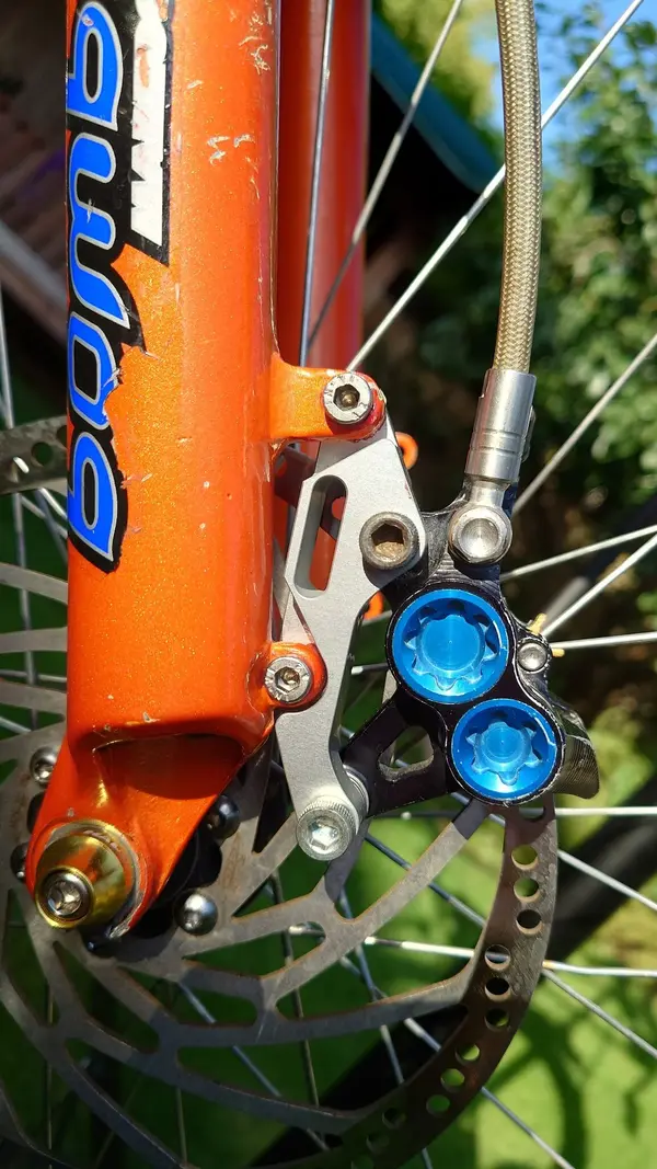

The blue does look good. The bike feels lighter than I expected too which is a bonus. I really like the blue bore caps on the brakes, I got lucky when they came up for sale.

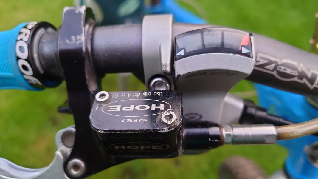

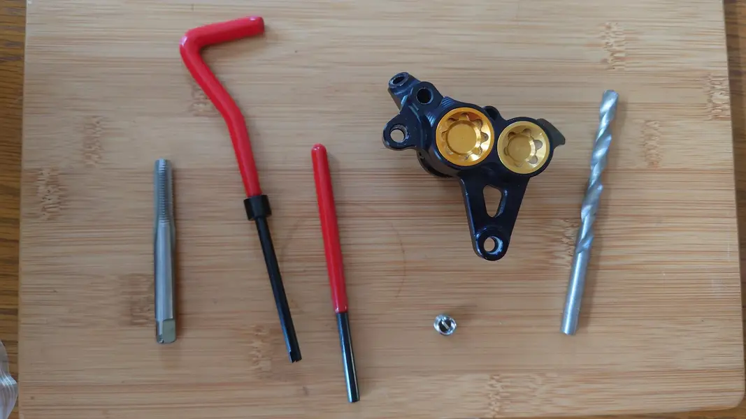

One of the brake reservoir bolts heads was rounded, I need to change the hoses so will need access to it at some point. I used my budget rotary tool to cut a small slot in the top, this worked a treat and can now change the bolt.

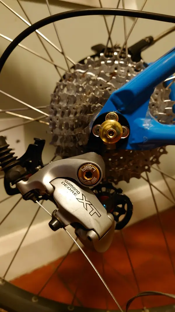

I also changed the derailleur bolt to match blue/gold theme. What's annoying is the text is upside down when. The previous red one was the correct orientation.

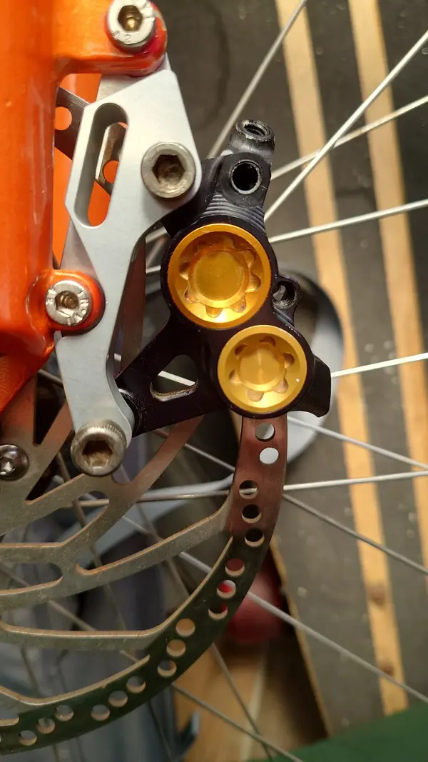

The steertube is way too long on these forks, but today I got some Z2s with a shorter steer tube for another project. This other frame requires a really long steerer, so I decided to swap the crowns. This is when I discovered the crowns are slightly different. It'll do for now and looks much better, but at some point I may swap the steeresrs if I find someone with a suitable press.
