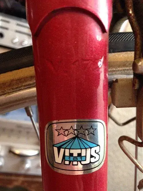

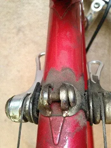

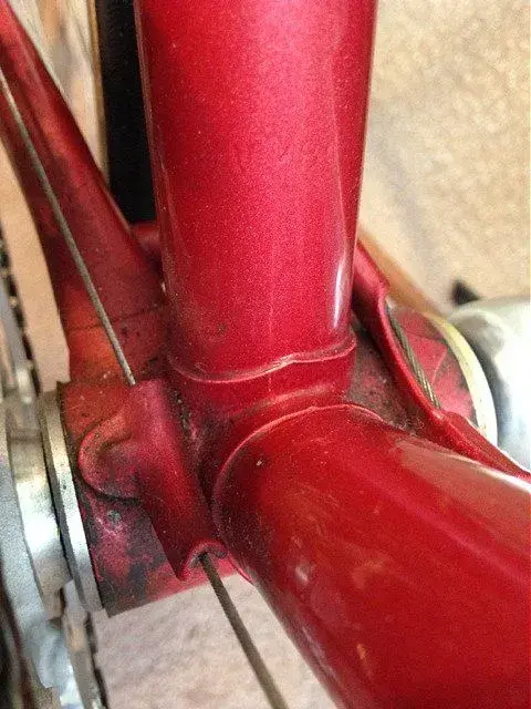

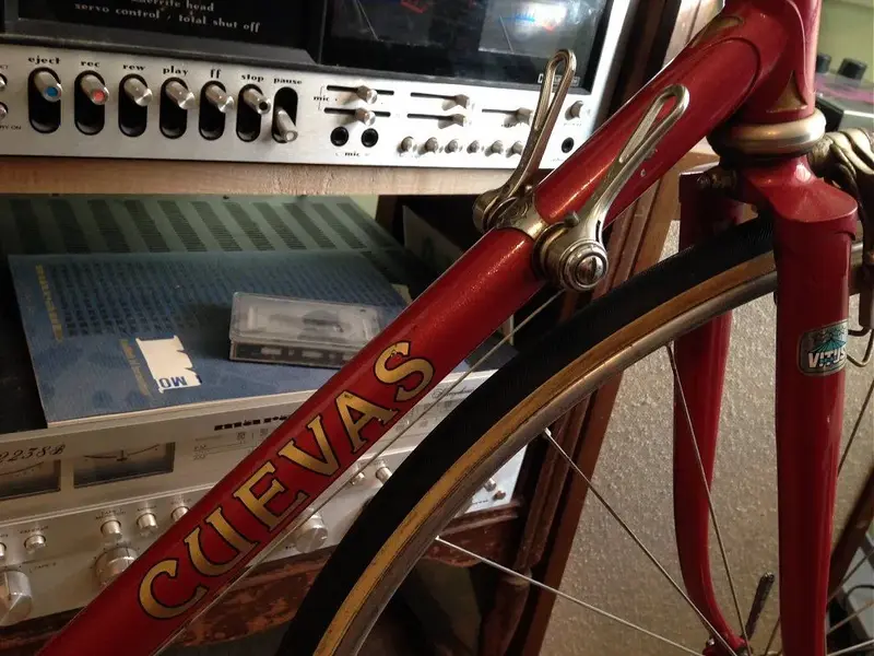

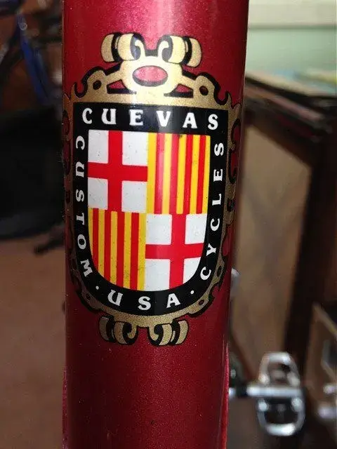

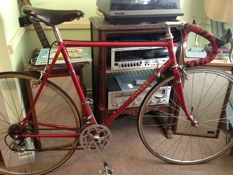

Posting pictures of my new winter project, a Vitus tubed Cuevas.
Frame and fork are in fantastic shape, a couple of paint blems but overall it looks great! Interesting (to me) that many of the frame tubes are stamped with Vitus tubing numbers; V.181 on the down and seat tube, V.172 on the fork blades. I've been unable to read any markings on the dropouts, Gieppieme? I haven't be able to locate a serial number.

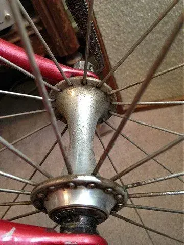

Build is going to need some thought but i'm keeping a few of what I feel are appropriate parts like the Zeus wheels (radially laced to Super Champion tubular rims), Omas headset, and Simplex shifters. Everything else seems to be of a later date?
This brings up my first question. Is there a way to date the frame based on construction details? I would like to be able to replace the newer parts with period specific if possible, and my wallet allows.
My guess right now is late 70's build?

Upon closer inspection, with my Mr.Magoo glasses and flashlight, I was able to id the dropouts, Super Vitus front and rear. Very cool! I suppose this dates the frame to the late 70's.

the Super Vitus tubing which did bear the number 971 and 980 were actually presented at the "Salon du Cycle" in Paris
The SuperVitus 971 in 1971 the SV 980 in 1980
I strongly suspect the double butted midrange tubing 172 and 181 were following the same pattern. so 1972 and 1981 ( one year latter than the upper range tubing )
Quite often, around these dates, you could find frames using both tubesets
So if your decals are correct, not a great surprise and as you suspect , the frame could be 1981 or 1982 using some Supervitus rear dropouts.
Its sometimes possible to see the engraving of the tube spec on the tube itself but it is light and very often masqued by the paint
Thank you for the excellent information! Given your insight and what appears to be the original shifters/headset the bike certainly points to the early 80's.
