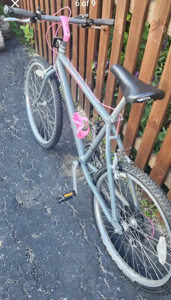

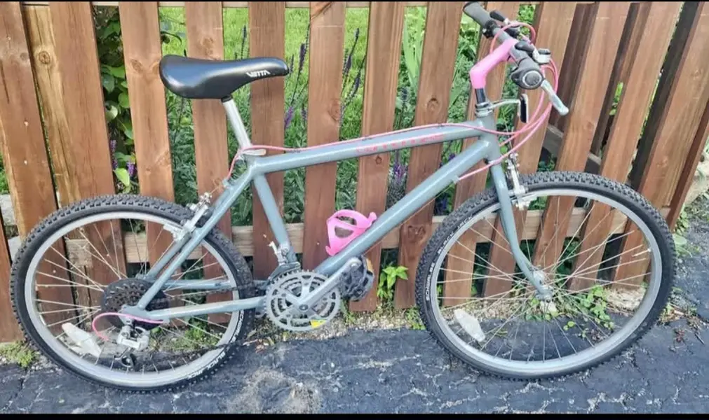

So I just found this 24 x 26 sm600 with a shimano deore drive and suntour roller cam brakes, that is in better condition. I might try to get this one instead. From what I can see, I think the white one is an 87 sm800 26 x 26 with a Suntour XC 9000 groupset (precursor to XC Pro). What are the odds of finding two of these in a week?

The crusty white seems to be the white version of the 87 SM 800 and the grey is a 87 SM 600
