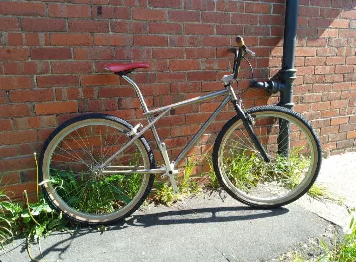

You might of seen this rolling frame elsewhere on here?
So it's a trusty plain gauge tange cromo timberline from 91 or 92...... Stout and sturdy.....and measuring in at a teeny tiny 14.5"...... cute! So Bob on fit with a bit of layback and riser bars for me at 5'10" it's comfy 😁

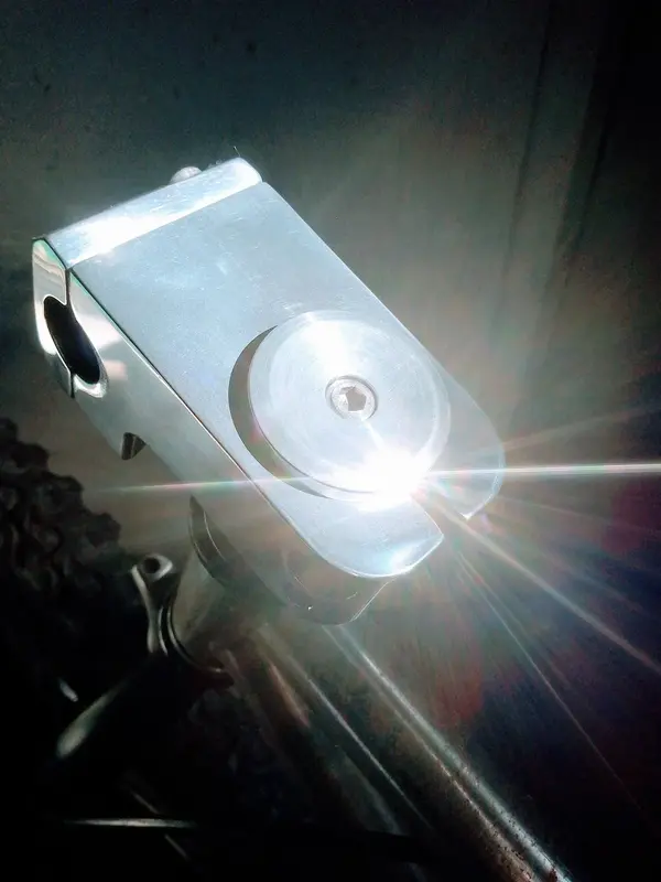

Well seeing as I know I'm comfy on this set up....let's set the stem height in stone with a nice custom made spacer and top off the stem with a matching custom cap!

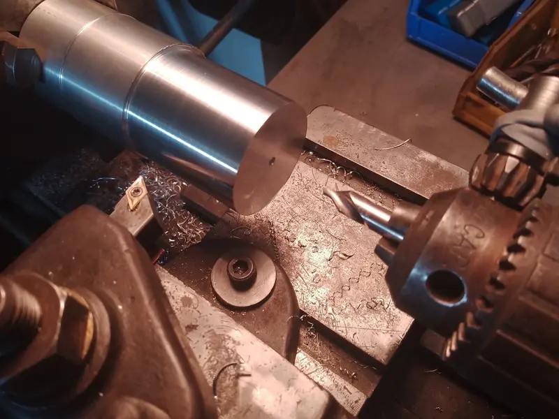

Start with a lump...machining both the top cap and spacer as one...
A few taper cuts...and a nice concave face for top cap

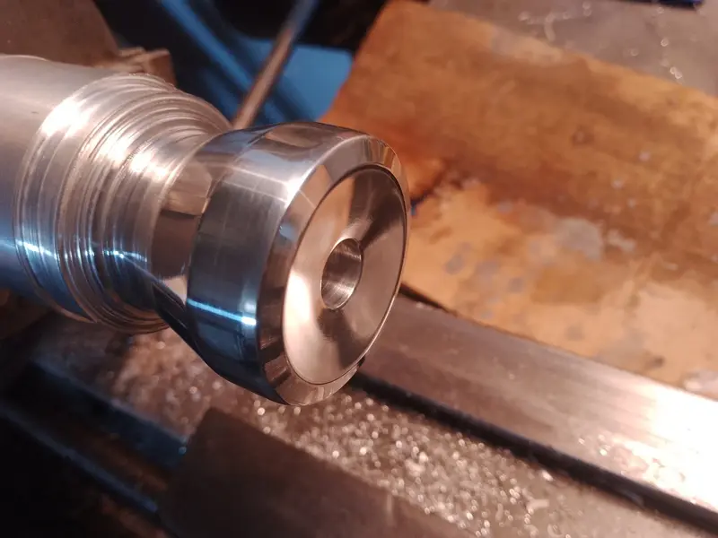

Whilst it's spinning get it wet flatted with wet and dry....start getting a proper finish on it👍
Start of a nice shine!

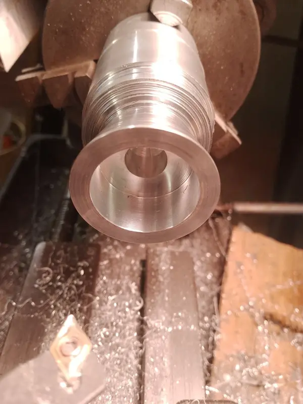

Separate the two...and bore a hole for the steerer tube....

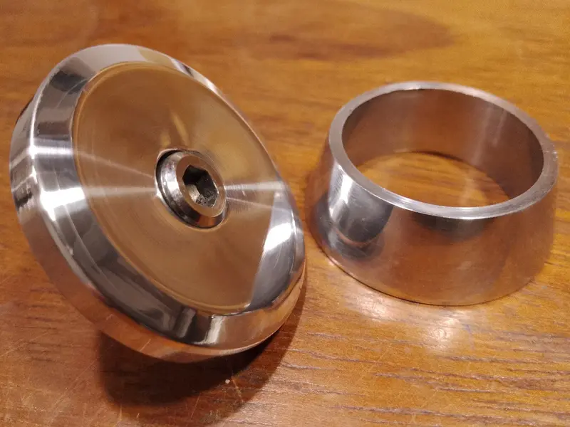

Cut off the bit I want add a stainless cap screw machined and polished of course ....
And that's part one....done !
Wonder what's next! 😆

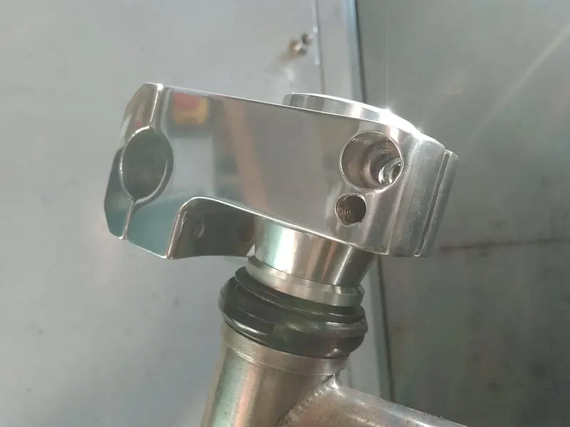

Well this morning I did a little bit of wet flatting of the stem on a sheet of glass ! Hoping to get it really flat and chrome like on the polish 😁 still got 1500 and 2000 grade to go....🤨
But it's starting to look Just how I want ,👍

You know, I would have given you a silver top cap if you had asked, though then I would not have seen your endeavors in making one, which i must say are satisfyingly fascinating to watch :cool:

Love the look of that. Looks like a cross between a cruiser and a freestyle BMX. I would say its a Bruiser-Cruiser, but only said with a very strong Scottish accent! 😜
I think it looks great unpainted, but more than happy to see it with some crazy-rad paint if you've got some creative ideas in your head. Need to keep that laid-back post 👍 it's integral to the bikes overall look.
Thank you kind sir! Here to entertain 😁
And a very generous suggestion ...could of saved me an hour or two!...oh well...🙄
