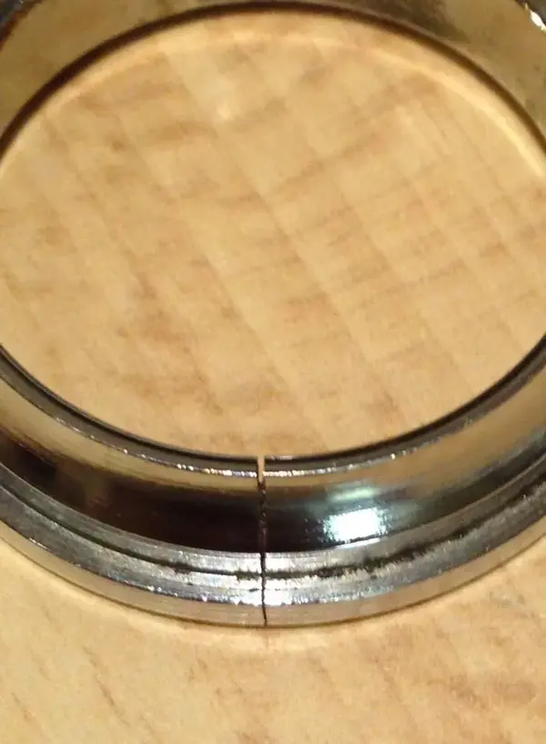

Bryncrug72 Senior Retro Guru Feedback View Apr 18, 2014 #1 Should there be a split in the crown race ? Attachments image.webp 43.9 KB · Views: 363
troje Rocky Mountain Fan Feedback View Apr 18, 2014 #2 Re: Nope. Kills your bearings and puts your steerer into one position. Not good.
Bryncrug72 Senior Retro Guru Feedback View Apr 18, 2014 #3 Thought as much ! the cut is very neat and fine doesn't look like it was done by a hacksaw
R Rampage Retrobike Rider Feedback View Apr 18, 2014 #4 Re: Cartridge bearing are fine. Balls are not.
Bryncrug72 Senior Retro Guru Feedback View Apr 18, 2014 #5 This came off the bike originally, the NOS 1" XT crown race has no split and currently doesn't fit might require a bit of fettling to get it on
R Rampage Retrobike Rider Feedback View Apr 18, 2014 #6 Re: What headset is the split headset from? The race that doesn't for could be a different size to the forks your trying to put it on.
Bryncrug72 Senior Retro Guru Feedback View Apr 18, 2014 #7 Re: Re: Rampage":3n3djhhr said: What headset is the split headset from? The race that doesn't for could be a different size to the forks your trying to put it on. Click to expand... 1" Deore 1989, that was on their when I got it , the bearings were really smooth tho ?
Bryncrug72 Senior Retro Guru Feedback View Apr 18, 2014 #9 In a race, they weren't excessively worn either, but they or the headset were not destined to be used again !
FluffyChicken Archivist Retrobike Rider Feedback View Apr 19, 2014 #10 Re: I assume a caged race. Anyway check the diameter of the steerer tube. There are two specification. You may be trying to get a 26.4 onto a 27.0.
