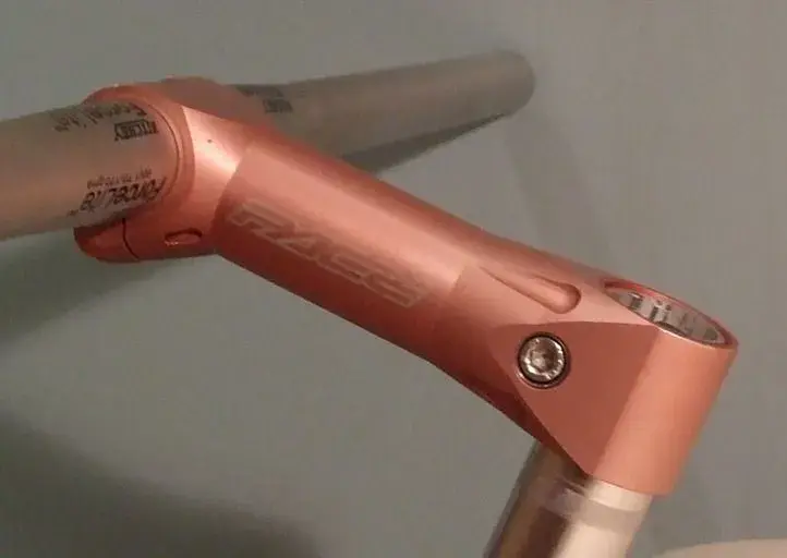

Apologies if it's too obvious to mention, but stems have various depths and various designs. If the stem you're using was by any chance 50mm deep, you could solve your problems by using one of 40mm instead. Or you could use a stem with a single bolt design, like this Pace which uses a pinch bolt.
