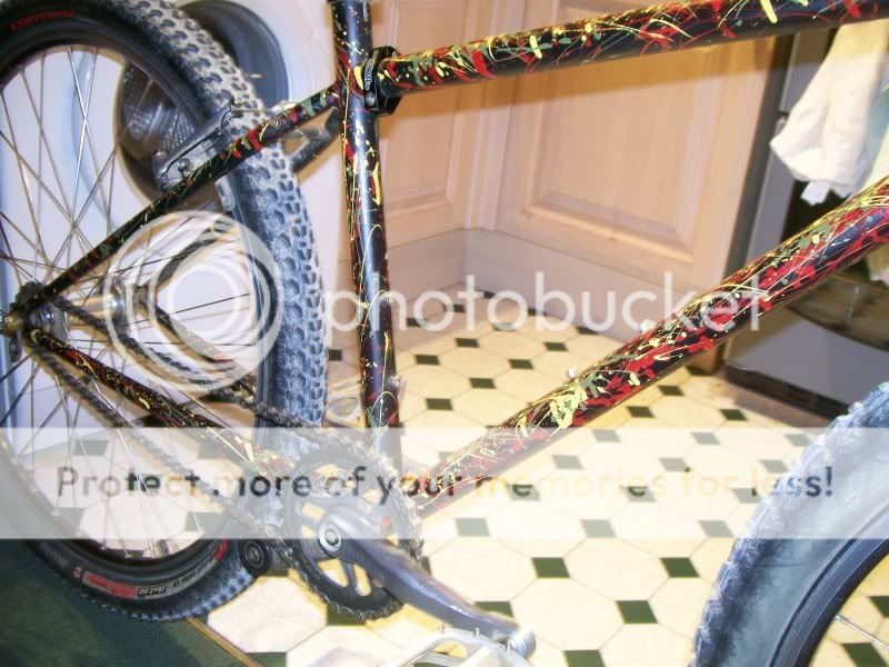

Isn't there a pretty substantial risk of smashing the crap outta the tensioner mounted up front?
Aesthetically, I prefer it there.....

Significantly better than all other bolt on tensioners
http://www.dmrbikes.com/?Section=produc ... emid=CDCR2
If your going to hang stuff from the mech hanger it might as well be a mech :lol:

You're more likely to catch the chainring before the roller but that never happens anyway . Doesn't get covered in mud either as it's out the way of the tyre . Even if it did get hit and the roller manages to push against the side of the chain it has already been over the chainring and the chain isn't under tension as it travels to the rear so the chain would stay on , any deflection as the chain comes off the chainring is lost along the chainstay length . Even if it's a bit rough it would still pedal . But bend the rear mounted tensioner and the chain would lift off the sprocket at the rear .
The rear wheel just slots in as there is nothing in the way like with a hanger mounted tensioner . If you wanted to get really technical having the tensioner in the center of the bike low down is a better place to add the extra weight than hanging it off the rear of the bike .

Chainline is the only thing that you need to get right . With both rings running perfectly in line the chain could be swinging in the breeze and not come off .
