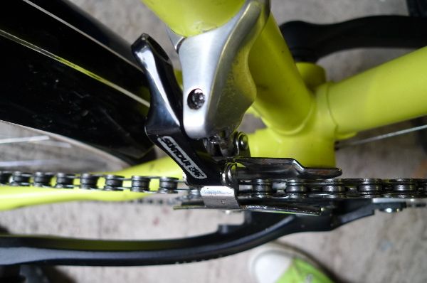

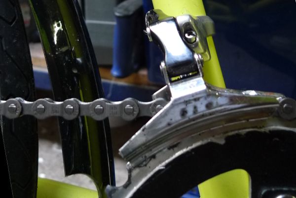

Anyhow, my bodge. I had a couple of front mechs lying around including an old pitted suntour LTD that I'd scavinged bolts from for another, so hacksawed away the end and bent the two plates together in the vice until they were a touch wider than the chain, fit then adjust to position using the stop bolts.
Looks like it ought to work, the chain certainly can't drop from the top anymore although it could still come off the lower side of the cog if I backpedal - I haven't had the chance to try it yet, to busy today getting mud on my clockwork :)
Top job, can't go far wrong for £2.

It's just a guide that clamps onto the seat tube, the cage is adjustable for the chainline. It's a really neat job but it's not going to do anything different to your solution, couldn't knock it back for £2 though :) .
