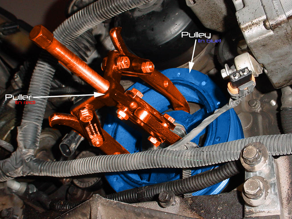

something along the lines of:
A pully/fly wheel puller.
Ive known a few bike shops to use similar on sticky cranks.
