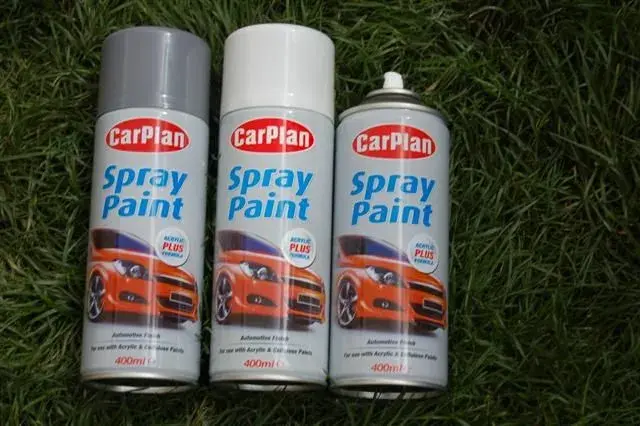

look great, but come on, details! type of paint, how applied, what oven, what temp
Thanks in advance :)
GREAT WORK
but +1... spill ze beans!
Was it just ordinary white spray paint?
Pics of the rattle cans, below :wink: 8) The trick is to have a few cans of patience and not try and cover them all in one coat :wink:
600g W+D paper where applicable
Oven was set on it's lowest setting around 50degC and left to warm up properly for 10mins (electric/fan assisted) and in all honesty the cranks were in there about 20 mins max (following a good overnight curing beforehand) as I didn't want the paint to melt :roll: :oops: :lol:
Not sure whether to do a final bake in the oven now, as I don't want the decals to soften and ruin in the heat, after all this effort :roll: :oops: :lol:
HTH??
