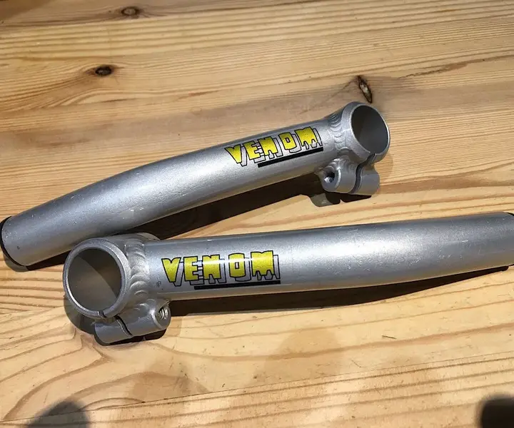

Most anodising firms would make a nice job. But with a minimum order charge of £250 you need quite a few bits to make it worth your while & then only if they are for keeps, not worth it if you’re pushing them on. Other option is to get a powder coating company to vapour blast then clear powder coat. But you may as well let the next custodian pay for that. Here are some bar ends I had done recently for £10

gibbleking":13pw7zyf said:
id forgotten about having the sprayed.hmmmmm
No paint on these, that’s fine vapour blasting then clear powder coat. Much tougher than paint
