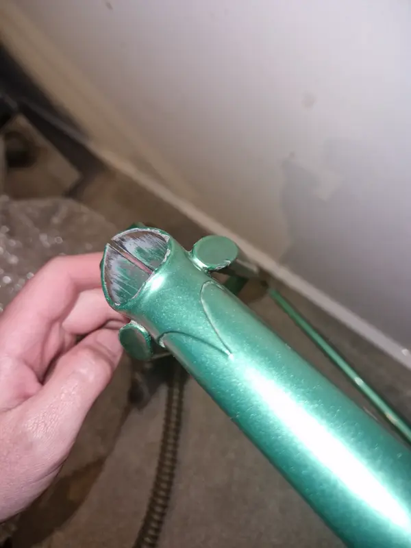

Hi all, I recently purchased a 70s tt frame, something I've always wanted... think Alf Engers style. On arrival I noticed what looked like a crack around the seat lug where the stays connect. I took it to a local frame builder who couldn't tell whether it was the paint or the steel itself. When I took it home I took a tiny bit of paint off to check and it unfortunately has a crack. As I purchased it off Ebay I can send it back for a full refund (seller has agreed).. however my issue is that I really like the frame. As mentioned I've wanted a 70s tt frame. It's very light, 2.15kg with forks. I think I know the answer which is just return it and keep on the lookout for another. However how repairable is something like this and roughly how much would I be looking at? Is it actually possible, for context the downtube and seat tube are the same external diameter at 29.3mm (seat tube id 27.2mm) the top tube is just under 26mm measured painted, so maybe the lug has been modified to fit

Probably a wider photo of the area in question, and of the frame itself would help.

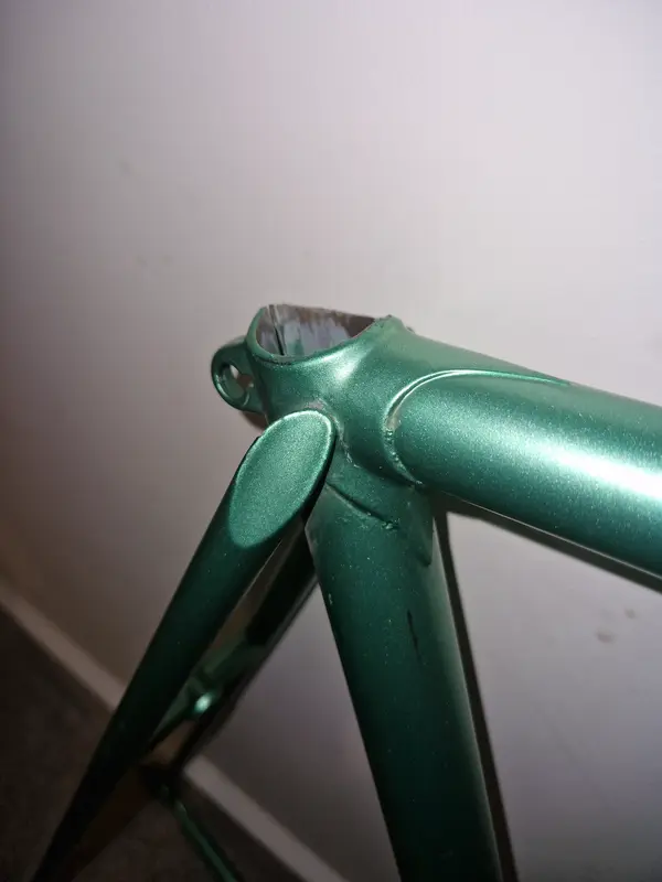

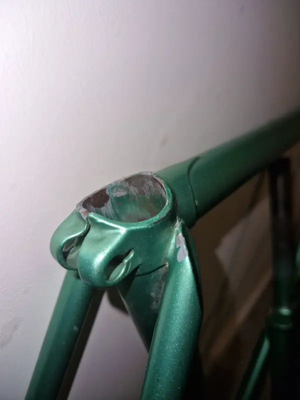

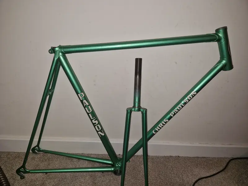

added some more photos, I was out and that was the only one I had to hand

Looks like a straightforward repair - it's possibly cracked by a corroding post expanding?
The repair could easily cost £100, and will need repainting.
You could negotiate a partial refund and get it fixed.
I can see why you like it. Very light too. I think it is in theory possible to replace the lug. It would be quite an operation though and it would need a repaint. In my limited experience with builders it can become costly very quickly.
That is light. Any idea what tubing it is?
Not really, the listing said some form of accles and pollock, but there's no stamps, decals etc. I couldn't belive my eyes when I stuck it on the scales. I think the weight saving trick lies in the skinny top tube. It's not been extensivly drilled like with contemporary Ken Bird, Shorter, Roberts etc frames, just some nice cutouts on the bb shell to match the headtube decal.
My worry is that it is lightly built, and the rest of the brazing might be going the same way. Stripping it back and inspecting/amending versus patching it up as you go. Either way, there are a lot of great frames out there for the money right now needing no work.
Given the terrible overspray it had had done I'd be collecting my chips and taking another punt.
agree that repair and respray costs from a framebuilder might put it out of reach for you and/or what seller might be willing to allow
in this image we can see that frambuilder did not add material to the interior of the seat binder ears for reinforcement
for a frame of this calibre it is common to do so when the ears are formed of stamped sheet rather than investment cast
Personally its a refund as they’ll be better frames out there if you are patient - unless your happy to pay costs for a proper repair & repaint alignment checks etc..that’ll be expensive
