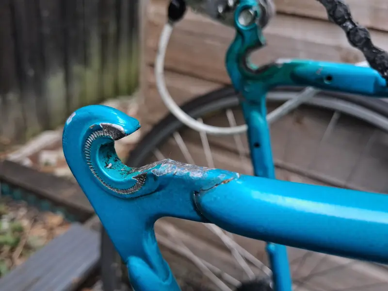

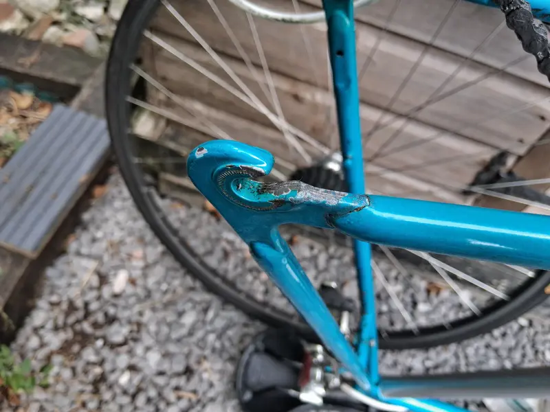

W widowmaker Gold Trader Roberts Fan Feedback View Jul 18, 2025 #1 Checking a recent acquisition over and noticed this on the rear dropout. I was possibly getting it blasted and powdercoated down the line. Just cracking paint? Thought ? Thanks in advance.
J jim haseltine Senior Retro Guru Jul 18, 2025 #2 From the way it follows the line of the joint I'd put money on it being cracked braze filler though there's a small chance that it's just the paint if the joint wasn't cleaned properly before the frame was painted. Not difficult to fix.
W widowmaker Gold Trader Roberts Fan Feedback View Jul 18, 2025 #3 Thanks for the info. A delicate blast may be in order.
grantoury Kona Fan Jul 18, 2025 #4 I would file/sand away the paint to have a look, if it is going to be painted
G Guinessisgoodforyou rBotM Winner Jul 18, 2025 #5 As above scrape the paint off and do a dye pen test.
W widowmaker Gold Trader Roberts Fan Feedback View Jul 18, 2025 #6 Do I need a special kit to apply this ? Homemade options
G Guinessisgoodforyou rBotM Winner Jul 18, 2025 #7 https://www.weldingsuppliesdirect.co.uk/ndt-kit-system-400ml.html First one I came across, please check more than I did
Nob rBotM Winner PoTM Winner Jul 19, 2025 #8 Looks like that’ll need a braze repair….for full piece of mind
W widowmaker Gold Trader Roberts Fan Feedback View Jul 19, 2025 #10 I agree, at the worst I got an almost mint RX100 groupset and minty mavic wheels i can use with a donor frame. I'll investigate further, it would be a shame to write the frame off.
