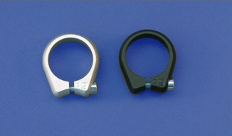

something more like a seat post clamp would be better than a jubilee clip.

If you have to resort to a clamp, DKG make some pretty big seatclamps at 1 1/2"(38.1mm+-0.2) and 1 5/8"(41.3mm +- 0.2). I've got both sizes in stock.

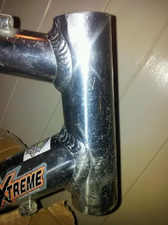

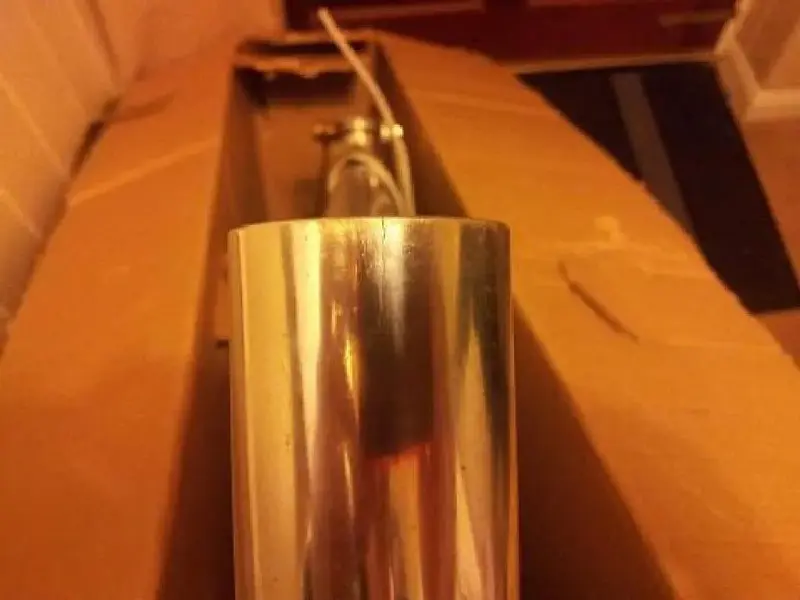

More pics:

don't mess about, get it welded by a experienced alu welder.
i once needed something doing like your headtube, googled local alu fabricators and found loads. someone in the workshop will do it for cash.
now, the result isn't pretty as, the result is a silver garden worm just where you don't want it but, it will be fixed right. :wink: although the new silver worm cannot be ground down(for safety reasons) it won't look too bad and you may be able to disguise it somehow :?
