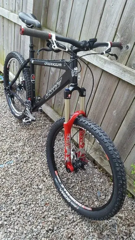

Managed to put the final pieces of this bike together today.
Will give it a shakedown ride over the weekend , but all seems fine after a quick ride down the road.
The brakes are fairly low end Shimano but did a good enough job on my old Inbred. I have some Avid Elixir brakes that need a service ( :roll: ), so they might go on the bike at some point.
And I may switch to a shorter stem, will have to see how it rides first...

Been having lots of fun with my Stiffee this year :D

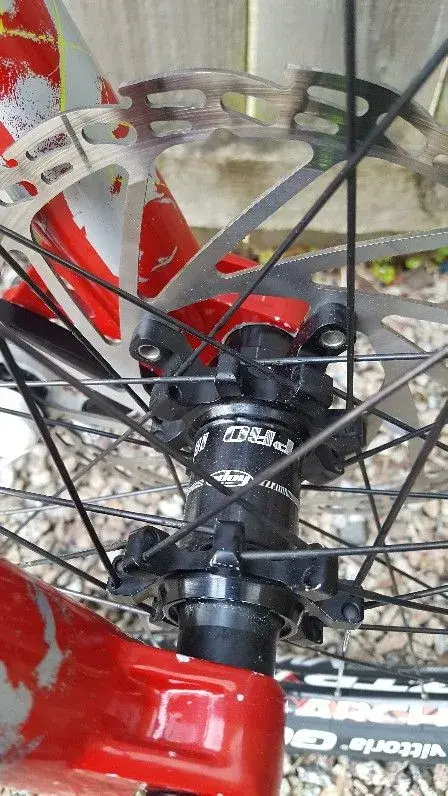

I've changed the forks for some DT Swiss EXC150's which seem better than the old Argyles, deal with the smaller bumps as well as the bigger hits with ease, and have a lockout function which is actually pretty handy for short sections of road riding.
Also gone back to flat pedals for the summer, £15 Superstar Components flats from Planet-X, plastic bodied, but metal pins, and loads of grip available.
This thing is super fun through the turns, and in the rougher stuff the front end smoothes over the bumps, just leaving me to hang over the back end and hold on!! :LOL:
