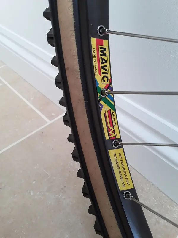

Ive been running ma40s (19mm rolled down road rims) off road on 1.95" and now 2.1" for over 30 years. Ive just built a new pair having worn the side walls out. Never had any issues off road.....and did some pretty stupid things on them in my youth!

Interesting. That was my experience too. I then started to do some of the 'built trails' stuff and after a couple of front wheel washouts, switched to wider rims and lower pressures, which did seem to improve things. But it all seems rather a dark art and I am interested in different takes.
