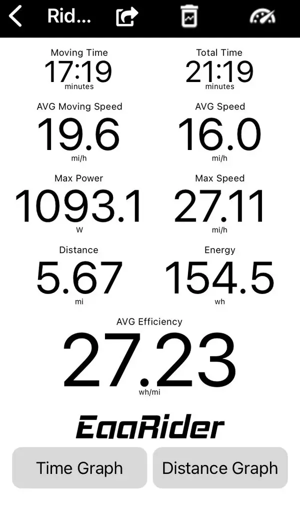

Thanks for reply, my only concern is the losing speed with 26” wheels, the High Latitude 29” cruises along nicely with the mid motor, need to work out the gearing and decide from there.
My commute on the High Latitude below.
