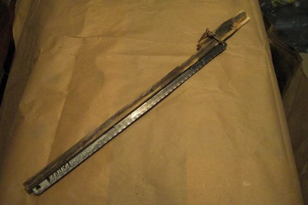

This method is recomended for alu posts in steel frames, however as mentioned I have never had any luck with it. Last resort is to chop the post shorter then use a pad saw or hack saw blade to caefully cut through the stuck portion of the post in the tube, not easy, takes time and concentration but will work.
totally agree
the tool:

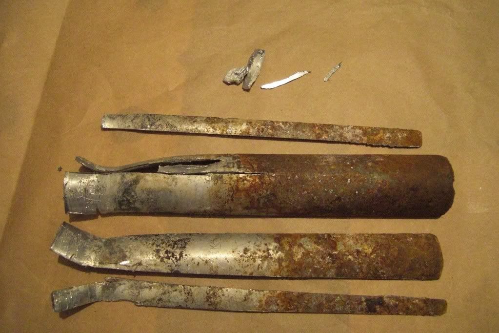

Kalloy 30,0 mm seatpost - wallthickness of 2,8 mm :shock:
4 hours of hard work - thanks to the seller who leave that bike out in the rain - night & day :evil:
