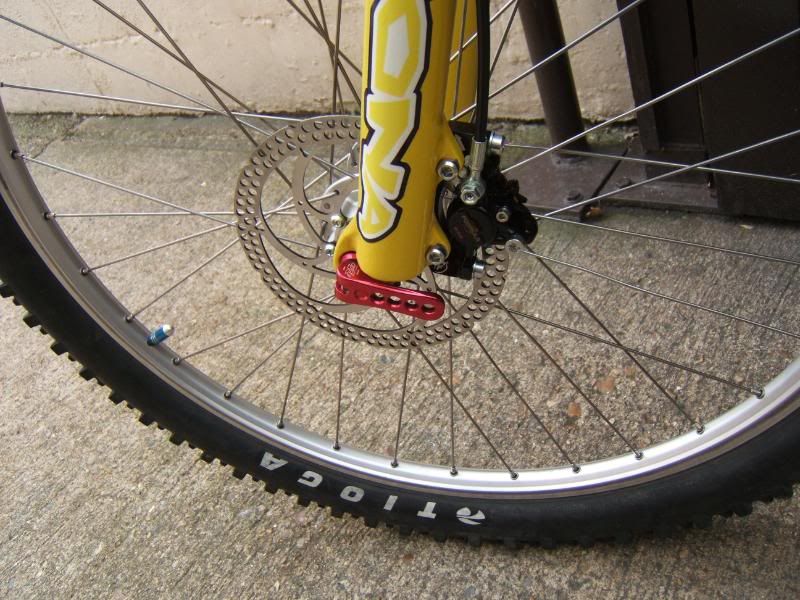

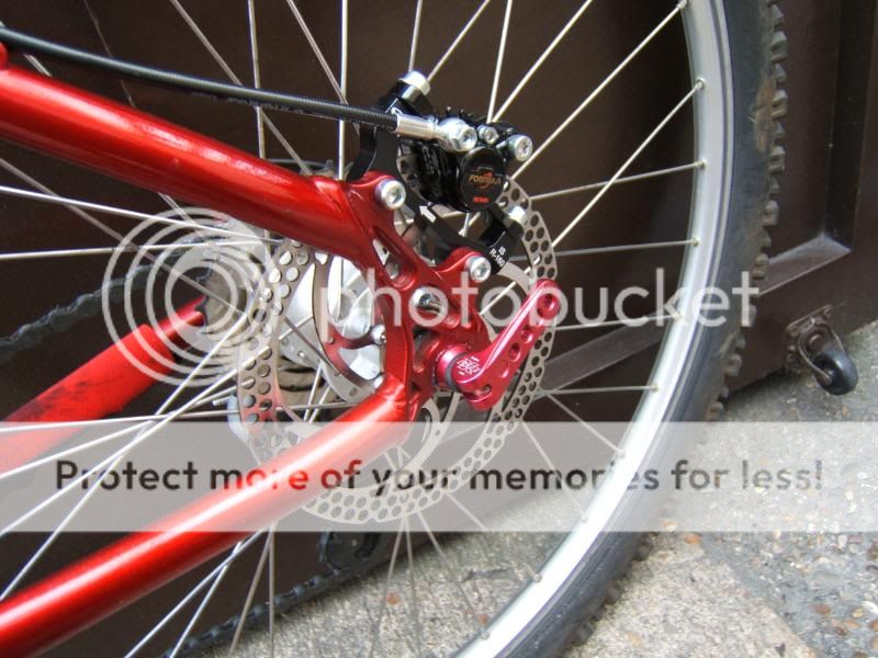

Recently converted my newest bike > Kona Kula 2002,
Was easy with the hangers... never looked into older bikes.
