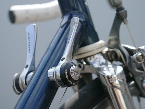

That reminds me, the Dura Ace 7900 10 speed Down tube shifters are a click click affair only. Pure SIS indexing, no option to switch to friction. Which is what I forgot to mention.
Like you, I could have continued using my 600 tricolore d/t shifters as it has SIS/Friction, but I was initially concerned that friction on a 10 would be difficult and I do like SIS anyway. Has it been easy to shift with friction on a 10?

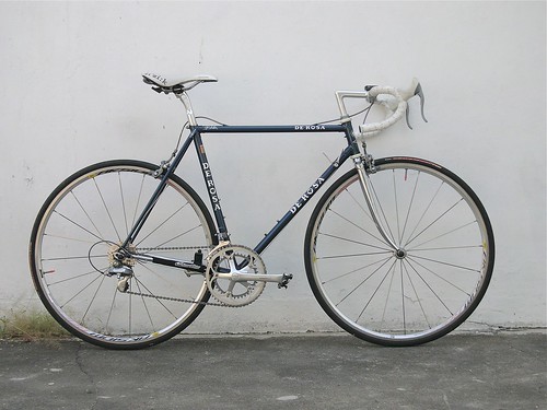

Here's the bike
L1060107 by paulblincoln, on Flickr

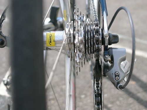

Its a full house back there
L1060096 by paulblincoln, on Flickr
These are the 7900 downtube shifters. Note: there is no friction selector
L1060098 by paulblincoln, on Flickr

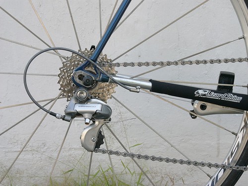

the 6400 rear d playing nice with the new cassette and chain
L1060114 by paulblincoln, on Flickr
