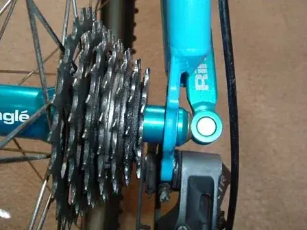

my chain line seems out tho with this hub and cassette mounted on the frame?? the gap between the last cog on the cassette and the drop out looks big -??
i think this is a dura ace cassette? road??
It's not a cassette - it's a freewheel. I don't think Dura-Ace was ever freewheel (unless very early on!) - certainly not circa '93.
But the block looks like it might be a road one.
If you're looking for an 8-speed freewheel, look for a Sachs.
