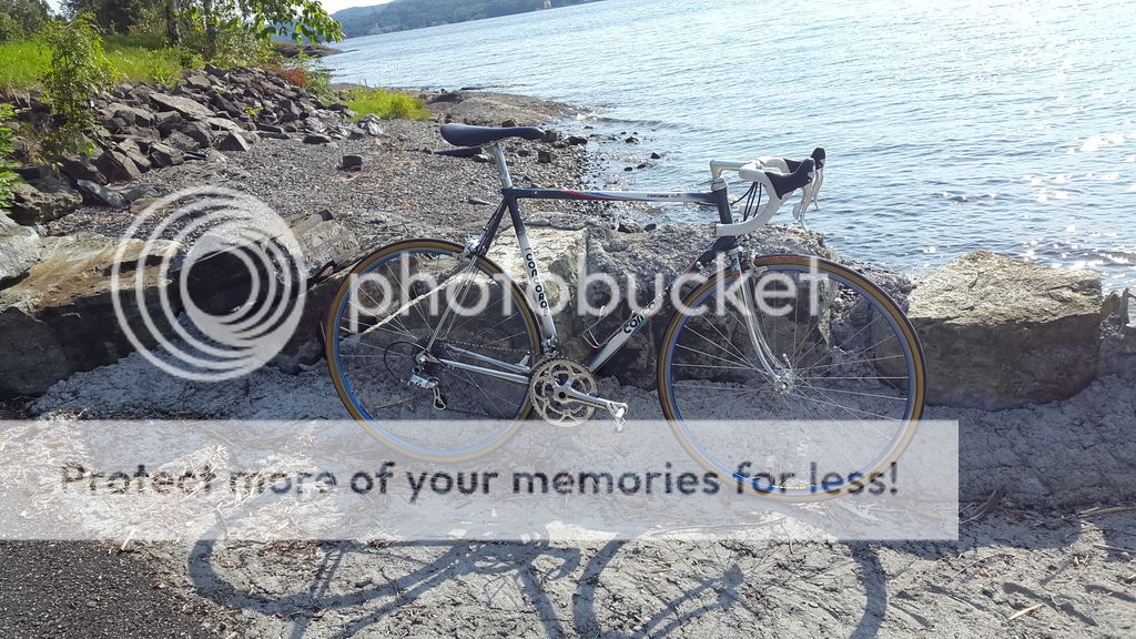

Finally started the strip down and clean this morning, and then spent five hours taking the Gavina apart so that I can get to the frame to touch up the paintwork.
Hit a couple of issues almost straight away:
Forgot about the vintage nature of the crank bolts...I dont have a 15mm box spanner and nether did the LBS round the corner, so I need to go shopping tomorrow to get the cranks off.

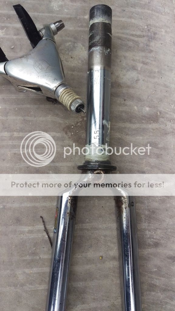

Next up was the front brake bolt... beautifully fused into the fork. I've been soaking it in gt85 for over a week and it made zero difference. I eventually had to remove the fork and rotate the whole brake out of the nut. I'll drill the nut out in the morning.
Minor issue with the stem, but the rubber mallet "malky" sorted it out in a couple of minutes.
The Headset was solid too... It took nearly 15 minutes of rubber mallet "malky" to get it out.

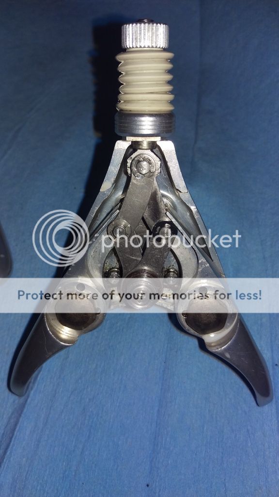

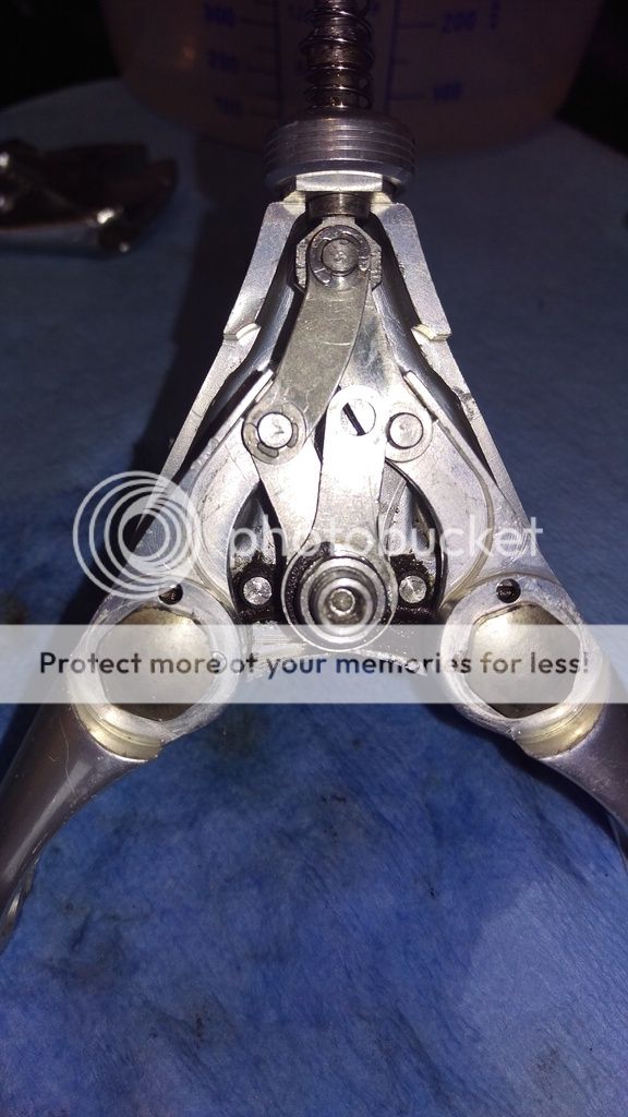

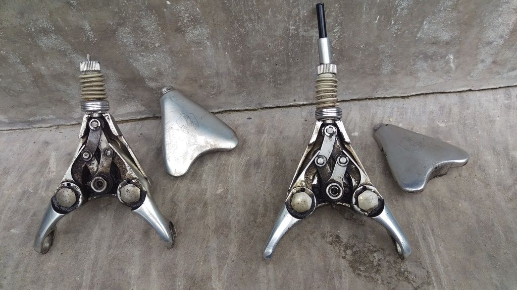

After that I gave the frame a quick clean (deep clean tomorrow) and got the ultrasonic cleaner out...
I'll post the results tomorrow, but here's how the deltas started
Anything look amiss here?
