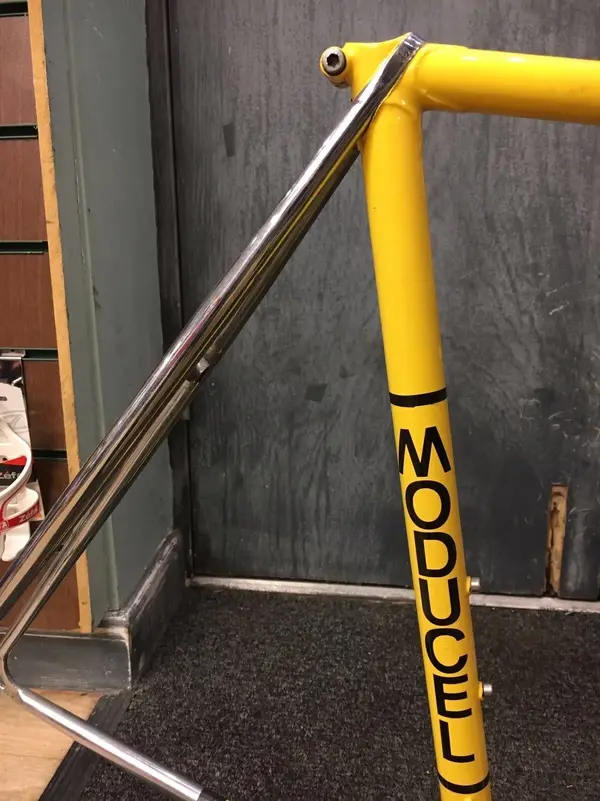

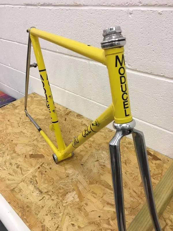

So it started with a yellow and black 56cm (my perfect size) "Moducel" frame, with design cues that indicated a Stoke-built Rourke and rumours that it belonged to an ex pro. If you want to follow the full "Team" story, visit my blog https://moducel.wordpress.com/ but this is the bike re-build thread...
Spec: head set (stiff), Shimano outboard cups and rust to chrome wrapover stays, 130mm rear. Research and a cross-reference of the frame number with Brian Rourke's shop in Stoke confirmed a 1984/5 Reynolds 753 frame and fork built for pro rider, Sid Barras.

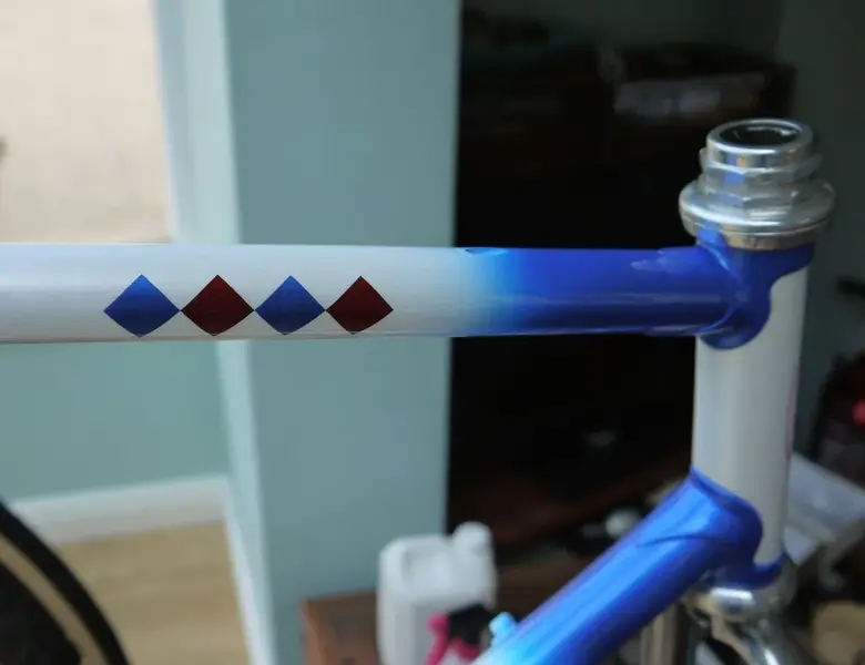

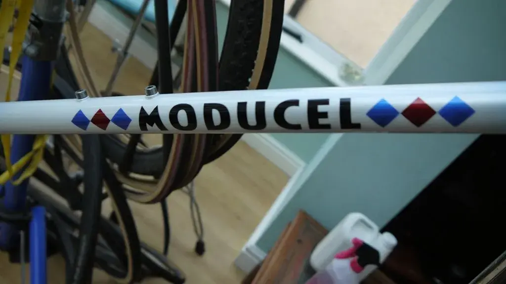

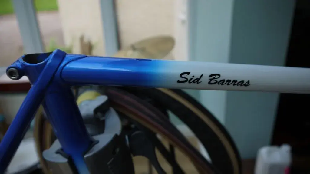

Frame refurbished by Jason Rourke: unfortunately the chrome wrapover stays couldn't be preserved (note to self: when buying Reynolds 753 frames check level of corrosion). Brief to Jason and the team was let's not be a slave to the original (after all the frame's been re-set at 130mm already), but keep the original feel and it's OK to step it up a notch with pearl paints etc. Chrome on forks kept as in VG condition. Hopefully, you'll agree brief met!

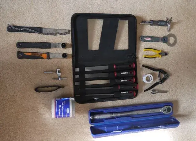

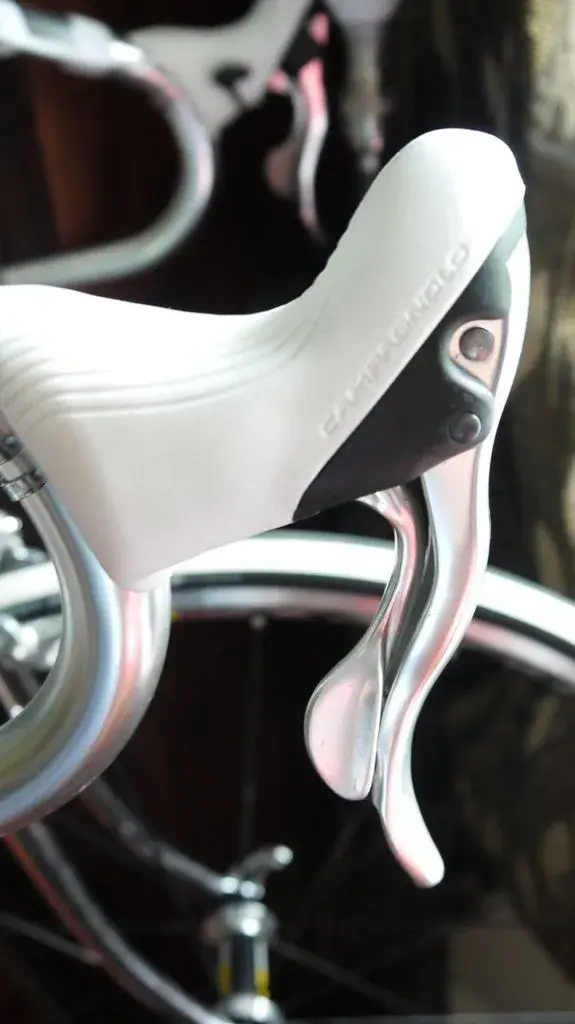

Mainly for my benefit, I'm going to detail the build so that I can refer to it as a guide for future builds: if it helps you too, then great!
Frame came complete with headset: any info on model appreciated.
Tools: I use a long Allen key socket with a torque wrench for the Chainset bolt: Campagnolo has a special tool, but this socket is way cheaper and does the job perfectly.
Bottom bracket cups: wind masking tape around cups (twice) before using cup tightening tool- protects the soft metal and its finish

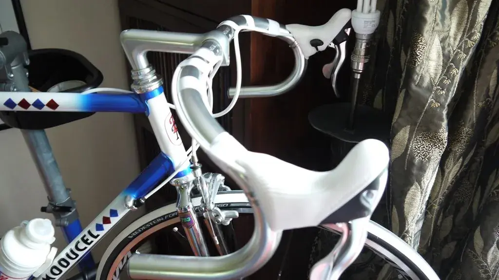

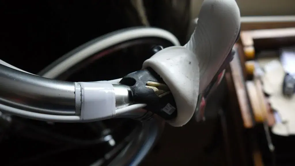

These Centaur 2009/10 ergos require a 3-4mm star shape- ended screwdriver (not pictured) to tighten the ergos via inserting the screwdriver underneath the hood from the front (tricky). Ergos require barrel adjuster cable stops: those fitted are by Jagwire, but Dura Ace are a better fit to frame (no gaps).
Frames with "diving helmet" rear derailleur stop require a stepped ferrule (3.7mm nose), 5 mm for the short rear derailleur cable. These aren't included in Campagnolo cable sets.
The chain breaker is used for shortening the chain and for joining using the Campagnolo pin (not a chain link in two parts) that it comes with. Follow Campagnolo's instructions v. carefully.
Insert the brake cables down through behind the levers, taking care to orientate the feeding barrels correctly. Correct gear needs to be selected on the Ergo levers to enable the gear cable to be threaded through the hole in the ratchet mechanism. Clicking through the gears will then feed the cable through. Use blunted cocktail sticks to push the cable down through the plastic channels on top of the ergo.
Replacing ergo hoods: warm the new hoods on a radiator: makes them more pliable. Start with hood at 90 degrees and insert and turn. Stretch over the thumb changer in steps using an Allen key to assist.

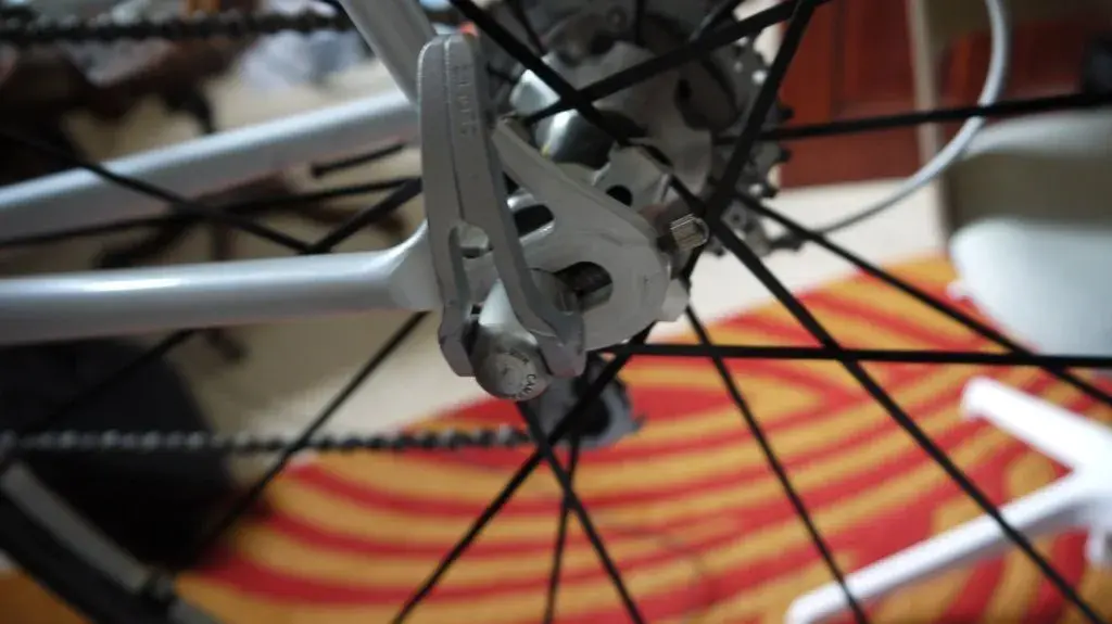

Use metal files to widen rear drop outs and grease wheel axles before inserting. These 80's frames when repainted don't have sufficient room for modern wheelsets- but a bit of filing soon sorts!

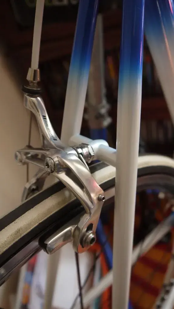

Centaur skeleton brakes- needed a selection of recessed brake nuts to fir correctly. Star washers were included which stop the brakes rotating.

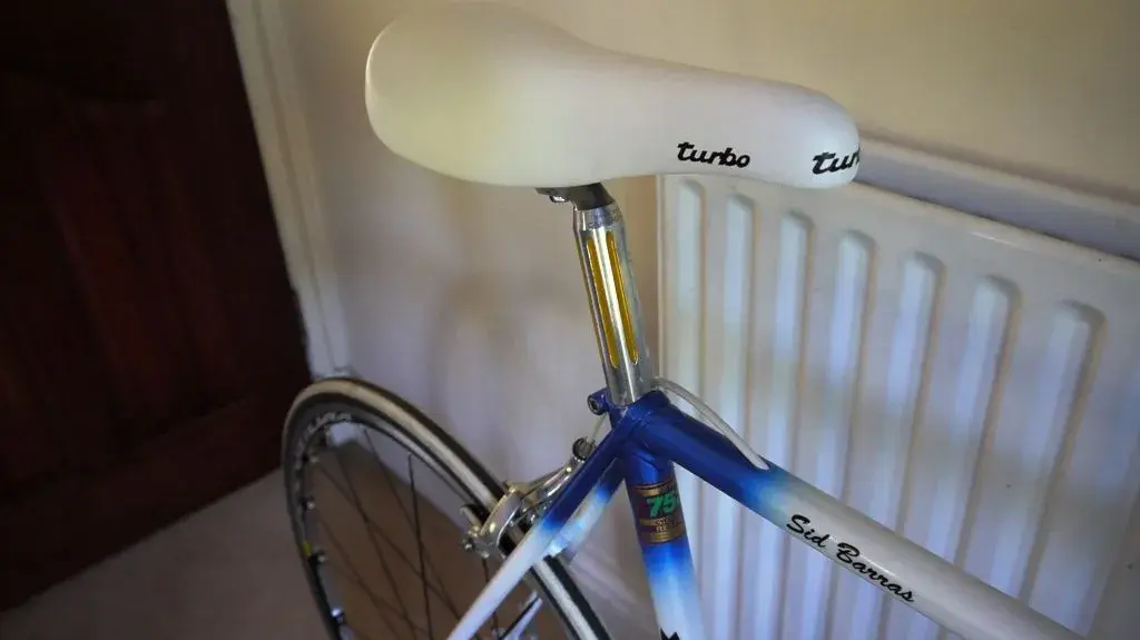

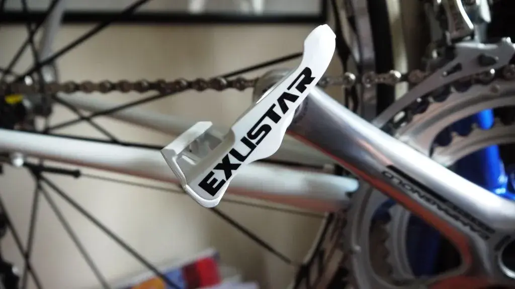

Found a very nice Super Record seatpost with long flutes (from Latvia). Highlighted yellow, I will look to overpaint in red or completely remove in line with original spec, as is the saddle. Taking the white theme through the bike with Campagnolo cable set, Turbo saddle and pedals. Skewers are Campagnolo Eurus, rare in Silver. Ksyrium wheels with Record 10 speed cassette. I had to rebuild the cassette as the spacers had been put together by an eBay seller who didn't know what they were doing and merged two partial sets incorrectly thinking they are all the same size :( a 3.9mm sized spacer hunted down on eBay to get the correct spacing. See link if you ever have a similar issue https://branfordbike.com/new-page-1/
Centaur carbon derailleur to replicate the look of Super record with black plate. Derailleurs needed minimal tuning: worked almost perfectly out of the box with cables tightened.
