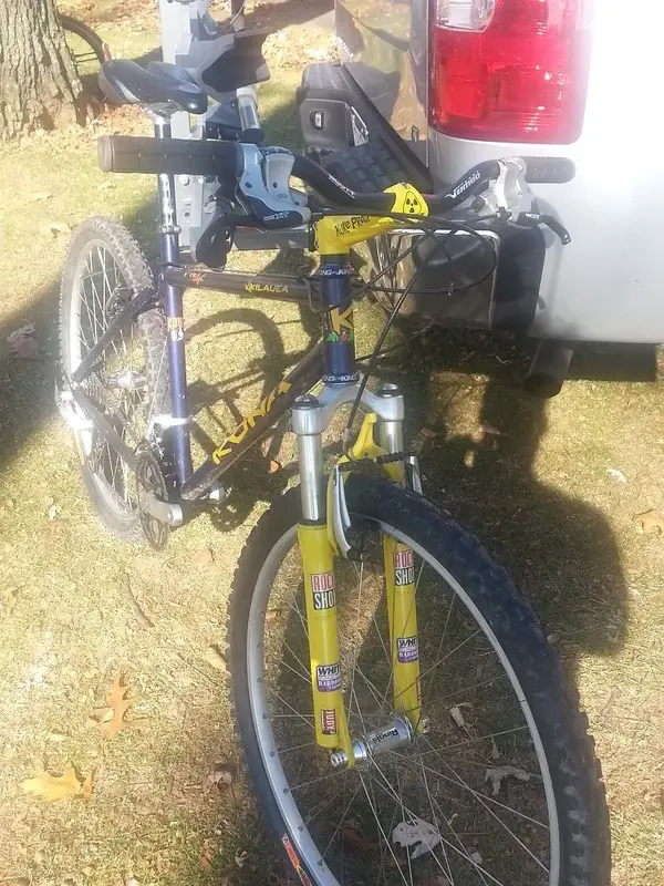

Upon inspection my "good condition" buy on the bay is cracked at the chainstay/seatube intersection. Email has been sent to seller. Very very bummed right now. :(
Re: Kona Kilauea Help
:facepalm:
Was reading this with interest and then this! Really sorry to read that, was all looking so promising.
Still awaiting sellers course of action. If things work out I may silver solder it since I will be add some cable stops on another build shortly, or have a mate weld it.
Then I'll be proud as punch again :D
Good news! The chap has agreed to refund enough to have the frame repaired which I will have done one day this week. Back on to happy times building and riding instead of sitting in front of the telly remembering holidays.

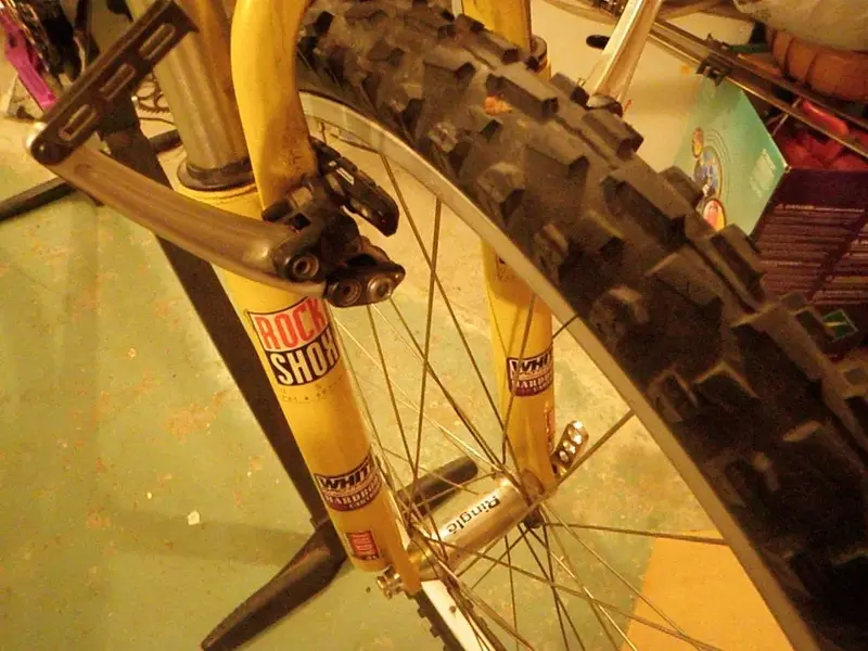

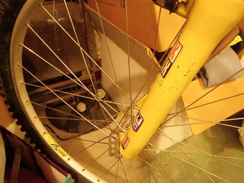

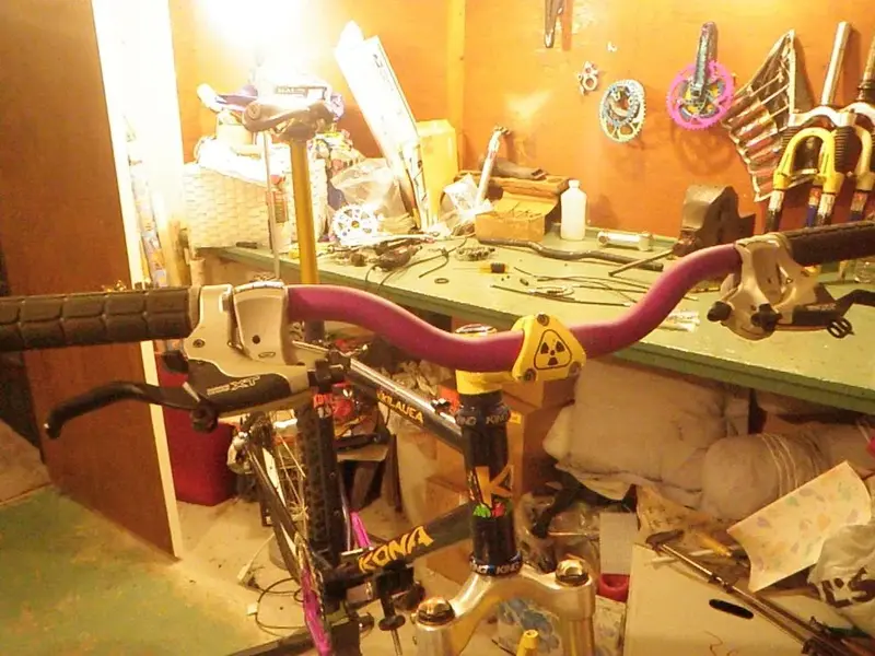

Build has started to progress. Only a few odd bits to come across, front mech., chain, pedals, cables and some granny spacers. Oh and also some blue nail polish for the bare spots on the frame. :D :D :D

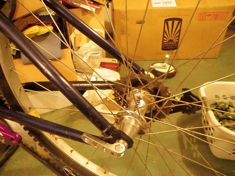

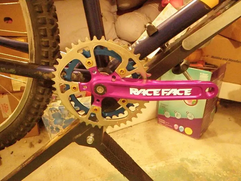

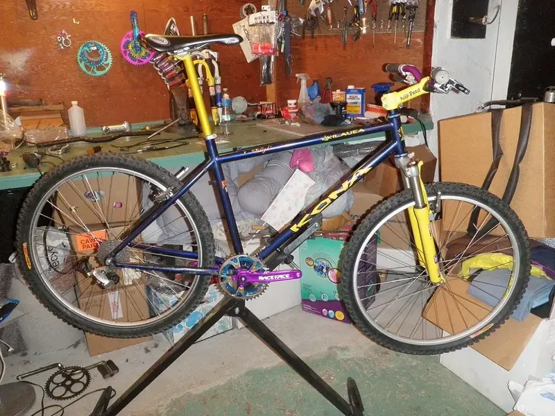

Time to dismantle and change directions on this one. Going to make it slightly more fit my needs than a hardly ever used back up bike. Will post current pics, of the now bike and the kit that will be used shortly.
Leaning towards making her a ss, dingle or tringle, possibly a 1x9/10.
Going to strip her down to bare and leave it raw, was going to go white, but was reminded that has been played too often.

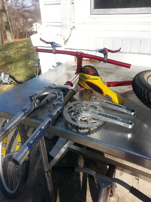

Well chaps, this is how she sits today.
And some pics of different kit for the makeover
Can't wait to strip her down and leave her raw :D
