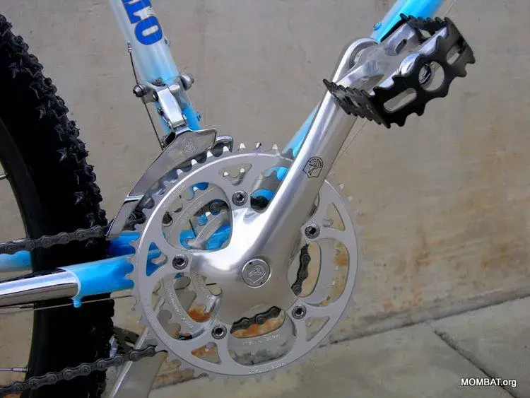

I've used a Campagnolo MTB crankset on one of my road bikes. Centaur/Icarus/Olympus is what you need (or Record OR if you are flash :)). They have an overall shape very reminiscent of 80s Campagnolo Road Gruppos, but are 110 bcd.
Run as a triple (or omit the inner granny ring as I have and use as a double). Velobase states that they need a longer BB than road cranks (124mm is given), but I'm using an Olympus crankset on the same BB axle as I ran a Record set previously. Perhaps better clearance for cranks on a road frame?

It's 110mm pcd, so will go as small as 34T.
However the MTB chainsets need much longer bottom brackets than Campag road IIRC.
A lot depends on what chainset (and therefore bottom bracket) you have already.
... or 33t. Hard to find, but they were made.
That was true of the earlier models, but they standardized on a 111mm symmetrical axle for all road and mtb cranks for the last couple of years of OR production. The upper models have the disadvantage of Campag's splined chainring attachment, but a '93 Centaur would make a very nice road touring triple:
http://www.retrobike.co.uk/gallery2/v/M ... g.pdf.html
Apparently there was even a trick 32T 110pcd possible with certain cranks - it needed a very slim spider and special ring bolts.
IIRC the only 33T was made by TA, haven't seen one in years.
I run a 24/39/48 Campag triple using 135pcd Campag road cranks, which is really nice with a 12-23 cassette. It all shifts fine and gives a huge range without the ghastly big jump of a 34/50. The 24/39 jump is less irritating as it's so uncommonly done - just once at the start of big climbs.
