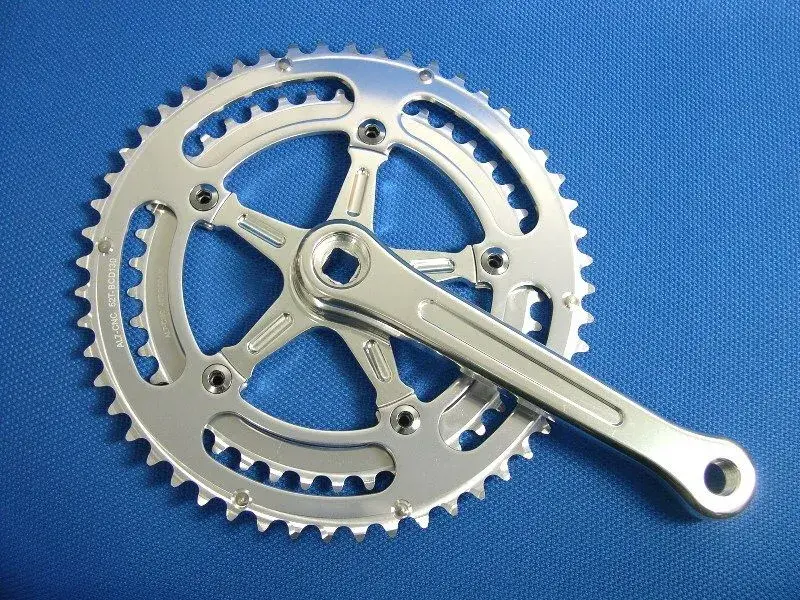

I really like this one from Andel but can't find a stockist.

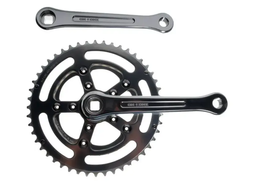

I've seen this On-One tourist but I'm not overly taken on the look of the outer ring but it is very cheap.

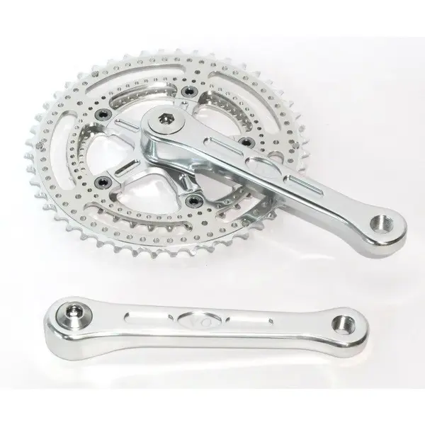

I like the Velo Orange drillium but £140 seems a little expensive to me.

The andel (Zenith) chainset is something I do. Give me a bell or drop me a pm. I am ordering on the 2nd Jan. can't remember the price at the moment.
