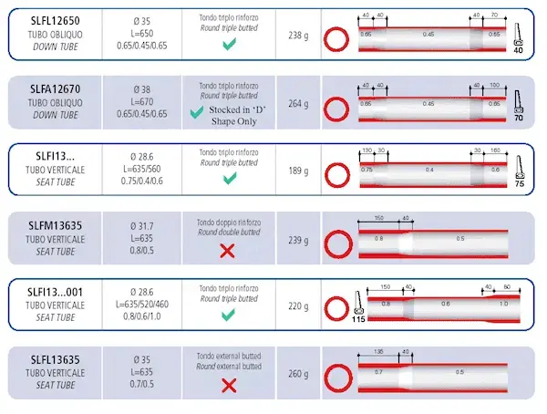

Referencing the tubing chart, and this is probably a dumb question but i'll plough on regardless, the seat tube: is the tube extruded to each frame size (or should I say total seat tube length) or is it a case of cutting sections to length that or as close as damn it to the chart?
Huge amount of effort if every tube was custom for a particular frame size.
I just noticed your question...
Not quite custom for each frame size, but there are 3 lengths of seat tube (560, 600 and 630mm) in MS. Unlike 'one size cut down fits all' MAX (where the taper is all within the bottom 200mm), MS looks like it had just a small parallel section at the top where a little could be cut off to get exact lengths. You can see that the Top and Down Tubes also came in 2 lengths each in the MS set.
The venerable SL and SLX etc. came with one length of each frame tube, with easily trimmable 100mm butts on each end. However, by the mid 90s, butts were down to 40-50mm (better materials, less weight), so sized tube sets were needed. Reynolds have alway had more of a 'mix and match' approach, with loads of different tube lengths listed, but no bundled size sets as such.
These days Columbus try to make a smaller range of tubing, fewer different lengths, but if you look at the LIFE spec below, you can see that the butts are not equal lengths(40/100mm etc). The cartoon saw and a maximum cut length mark the longer end which can be cut. So the builder needs to make sure that they use the tubes the right way around, too. Generally you need to work out which end will have the longer butt once the length has been trimmed and build that into the more stressed head tube end:
Also, you'll see that the more traditional single butted seat tubes designed for lugs have straight walls to the top section, as usual, cut to any length..except for the lightest one (SLFI13) which is internally double butted and comes in 2 lengths.
On the other hand, the TIG seat tube (SLFI13...001) comes in 3 lengths, all with an external 1mm butt at the top (less distortion from welding) and with a bottom butt which can be trimmed by up to 115mm.
That's enough tube stuff for one evening :D
All the best,
