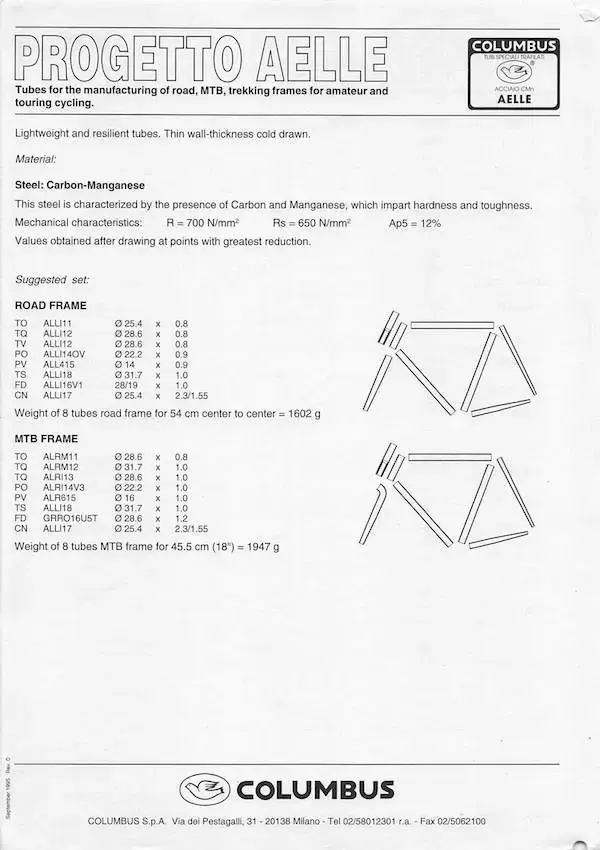

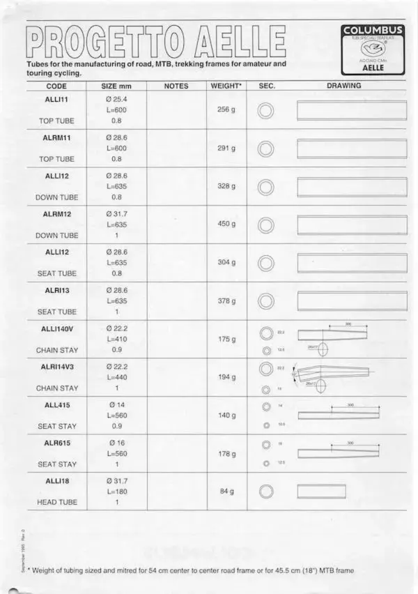

Columbus Aelle, any good?
Re: Re:
fettler":on4tpzvz said:
Isn't the Aelle a seamed tube? Ok material but a crap(cheap) production method.
Like a rump steak binged in the microwave?
I personally think its along the lines of 3 half decent main tubes with the rest as plain gauge steel
Dont think its seamed though
Costcutter rump steak?
The ride will depend on how it was built anyway, Columbus and Reynolds decals dont guarantee anything.
*looking at the frames made with Aelle, I doubt it will be bad anyway.
Sure Aelle was welded before cold drawing so it might not be obviously seamed as it was done before shaping.
Doesn't matter if it's from Costcutter, it's a quality microwave
My Concorde Astore is made of Aelle R; it is not heavy and rides beautifully.
It is a lot nicer to ride on many of the country roads around here than some of my frames made with more rigid tubsets.
Sometimes ride quality is more important than technical specifications.
If you look at how double butted tubing is actually made, you can see why there has to be a cheaper alternative. Besides the blank tubing metal often being more expensive, the tubing has to be drawn around a mandrel and then opened up at one end to get the mandrel out, then re-rolled to the correct diameter again. There are a lot more steps and some very precision machines.
Plain gauge seamless carbon manganese....OK and out of a decent factory, but nothing special: Think 531 PG.

Too much emphasis is put on tube metallurgy - it's the design of the tubeset (butting, diameters etc) and appropriateness to intended use that most determines how a frame will perform. (And the frame builders skill and selection choices of course.)
The quality of the steel used is simply potential for the tube-design.
Nowt necessarily wrong with seamed tubing either... IIRC, True Temper make seamed tubesets and some of them are very nice pipes indeed.
Yes, ALL of the true Temper tubes were welded seam then drawn, butted or not...nothing wrong with it as a method.
